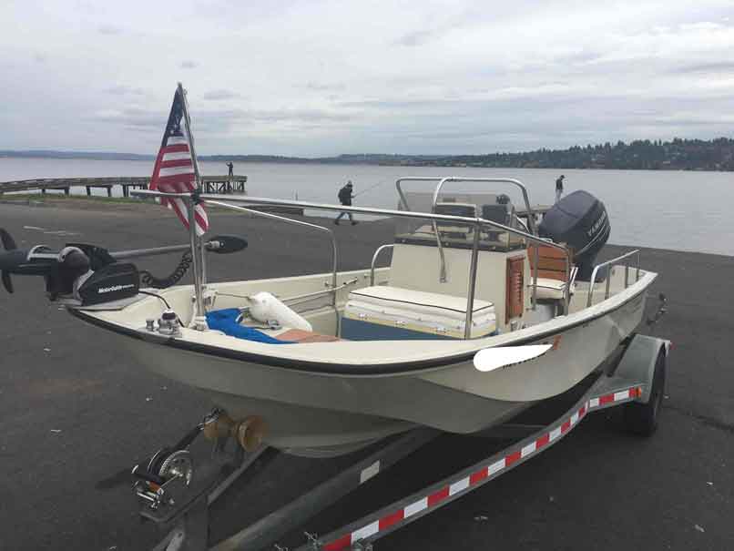

1. Regarding the glassing/painting, what is a reasonable rate? Take for example the trolling motor as seen in one of the pictures. How much would a skilled craftsman charge me to fill the holes and blend the color? Should I just have the entire inside painted over?

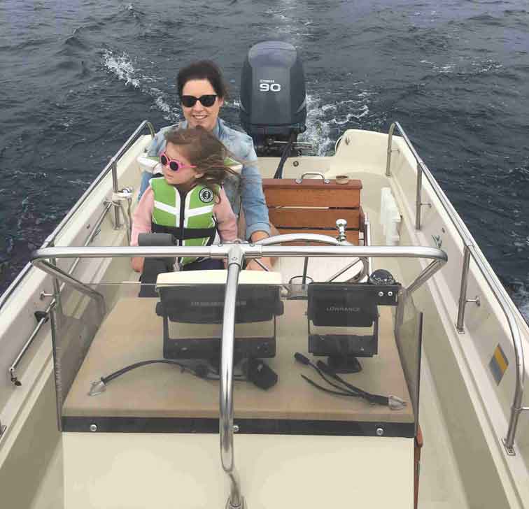

2. The console has plenty of small drill holes that have either been filled and not painted or need to be filled and painted. The windshield also needs to be replaced as the previous owner drilled and secured a small compass with rivets. Some other moderate repairs are needed to fix the console. Should I pay someone to do it and will they be able to do a good enough job so that it's close to perfect or should I pay the $1600 minus my USCG discount (Semper Paratus) to Specialty Marine for a new console entirely?

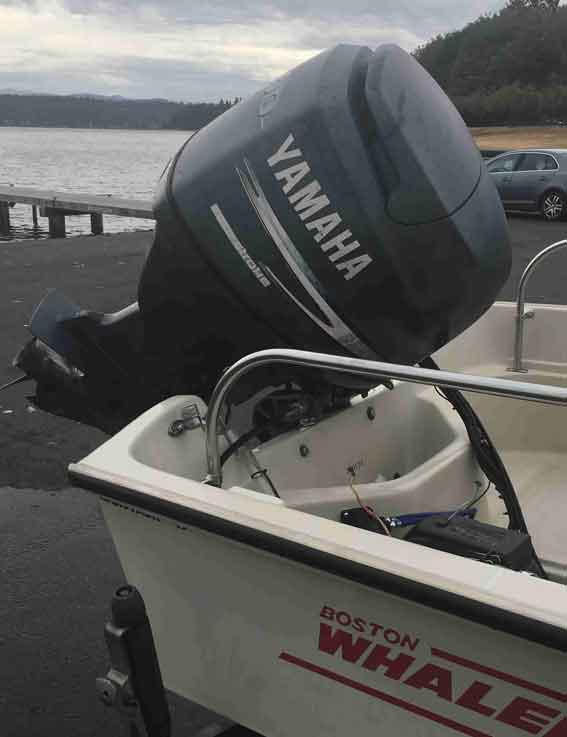

On my 1988 Montauk I have a 2001 or 2002 Yamaha F90 with fairly severe sun damage to the cover and decals. Replacement decals are easy to find. What is the best option:
--replace an outboard top cowling, or
--repair an outboard top cowling?
Besides eBay, where is my best option to find a replacement cowling?
Does anyone know of a specialist who can do this type work and cosmetic work?
I would be open to shipping the cover

It would probably be cheaper to paint the cowling or have the cowling painted by a pro.

As to Question #2, if you want to keep the original appearance, I don't think the Specialty Marine console will satisfy you. I can't tell from your pictures, but I think your 1988 boat probably has multiple faces, with the binnacle sitting up higher. The aftermarket substitute looks to replicate an earlier model.
