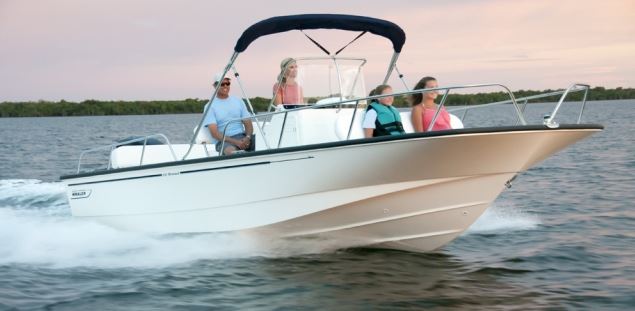

On the newer Montauk series of boats, I do not think Boston Whaler designed the Bimini tops to be run with the top in a folded down position. On my 170 Montauk I have the same concern you have described. The proper way to run with the top in a collapsed position is with the top up and the cover on with the middle straps attached to the center console's windshields railing clip holders.
190 Montauk.JPG (35.62 KiB) Viewed 20853 times

I tried running like the picture above up and cover on and it wobbles and straps loosen or plastic buckles snap. I can run with it bagged or up if water is flat. I would cruise at 20 mph in choppy water.

Ridge Runner wrote:On the newer Montauk series of boats, I do not think Boston Whaler designed the Bimini tops to be run with the top in a folded down position. On my 170 Montauk I have the same concern you have described. The proper way to run with the top in a collapsed position is with the top up and the cover on with the middle straps attached to the center console's windshields railing clip holders.
Running like that and the straps buckles snap in quartering seas. The whole frame wobbles side to side. I even did the same as above putting cushions under rail at the front. That decreases the angle at the [TACO MARINE ball and socket hinge].
