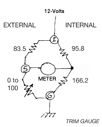

Pondering what might be inside the TRIM gauge, I came up with the idea of the meter being arranged in a bridge circuit. The circuit seems to be like this:
Trim gauge measured resistive values
The use of an external resistor across the I and S terminals always had me puzzled. But this is really a very good idea. It allows the manufacturer of the gauge--which is very likely not Evinrude themselves--to make a universal gauge. The value of the resistor installed externally at I and S is related to the range of the TRIM SENSOR that is connected between S and G. The internal resistors values are selected to work well with a range of external resistors values. This allows the gauge to be used with various ranges of TRIM SENSOR resistances. For example, suppose another outboard engine manufacturer used a TRIM SENSOR that varied from 5 to 200-Ohms. By changing the value of the external resistor connected between I and S, the same trim gauge could be used with that new range of values for TRIM SENSOR.
The bridge arrangement also explains very nicely why the meter reacted so unexpectedly when the ground connection to G was removed. The bridge balance was completely upset and much more current flowed through the meter. That is why the meter pegged so hard.
I would love to disassemble an old TRIM gauge to see if the internal circuitry is the same as my hypothesis. If anyone has an old TRIM gauge that no longer works, I

The resistance of the coil of an ammeter is typically very low, perhaps only a fraction of an Ohm. When I measured the resistance from the three terminals (with the external 83.5-Ohm resistor disconnected), I was probably measuring the coil resistance of the meter in those measurements.
If
RM = resistance of the meter
R1 = the internal resistance of the upper arm of the bridge
R2 = the internal resistance of the lower arm of the bridge
Then
I to S = R1 + RM = 95.8-Ohms
S to G = RM + R2 = 166.2-Ohm
I to G = R1 + R2 = 262-Ohm
Solving those relationships leaves RM = 0, which may be close to the truth. The resistance of the meter coil is very low, perhaps only 0.1-Ohm. It may be too low to see in the measured values unless very accurate resistance measurements are made.
Another clue that perhaps the meter is wired into a bridge circuit is the meter itself. It appears to be a Zero-center meter, that is, a meter that shows current flow in two directions, with the rest position in the center. When there is no current flow in the meter the dial pointer drifts toward the center. would love to take it apart to see exactly what is in there. I do think the bridge circuit I describe (above) is very likely what will be found.
