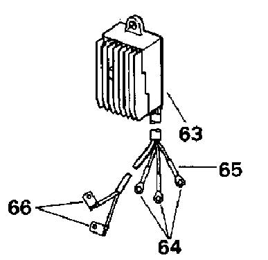

What does this rectifier/regulator look like?
I have the non-gauge alert system.
Bob
Re: 1996 Evinrude 70-HP Tachometer
Postby jimh » Mon Oct 23, 2017 4:08 pm
Bob--I am certain the factory service manual has an illustration that shows the rectifier in the manual.
To see a drawing of components of almost any OMC engine made in the last 25 years, visit the website SHOP2.EVINRUDE.COM.
For your engine, select the category EVINRUDE. Select the year 1996. Select the horsepower 70. Select the model E70TLEDA 1996. Select the drawing IGNITION SYSTEM. Select the part with callout 63. You will see a drawing of the rectifier assembly.
1996 Evinrude 70 Rectifier from the on-line drawing contained on their excellent website, SHOP2.EVINRUDE.COM

Thanks again Jim. I thought [the rectifier assembly] might be [as shown above].
