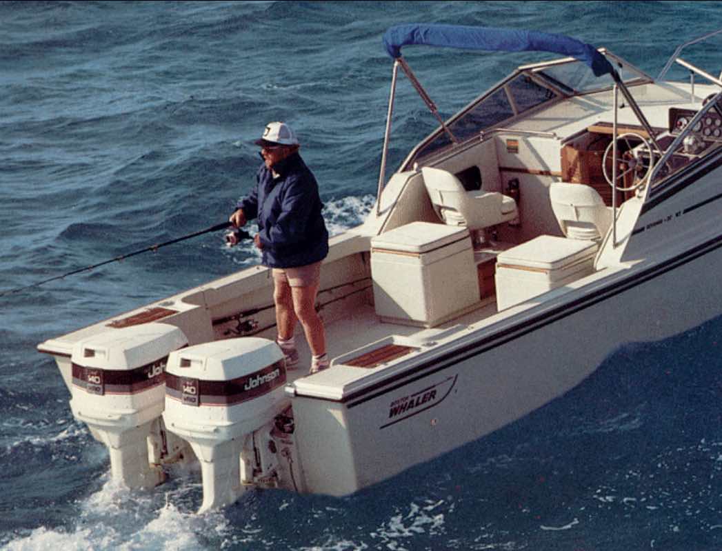

Boston Whaler offered an option on the REVENGE models in some years for molded seat bases that gave great storage compartments under the seats. I first saw these on a beautiful REVENGE 25 W-T Whaler Drive boat (owned by Russ in Wisconsin). The boxes elevated the seat mounting posts so only a very short aluminum tube was needed to position the helm seats at the proper level. The boxes extended aft behind the helm seats, and had large opening lids. These factory accessory seat base and storage boxes were great places to store gear.

Does anyone have a picture of the original factory option of pilot seat / workstation that was available on this boat? I am interested in something similar for my 20 revenge.

Postby jimh » Mon Nov 06, 2017 10:27 pm
I have only see these seats used on the REVENGE 25 W-T. In the catalogue they were also pictured on the REVENGE 25 W-T.
Optional seat base with storage seen on REVENGE 25 W-T

Postby wamair » Tue Nov 07, 2017 1:24 pm
I don't plan on making my box's that big. I want to be able to swivel the seats around and not loose so much deck space. When I start the project I will post pics ( as soon as I learn how to. I am new to the site. I'm a lot better with a wrench than computers)
I have my oil tank behind the pilot seat and I plan on moving the batteries to the same spot inside the box to help offset the 15-HP kicker that's mounted on the left side.
