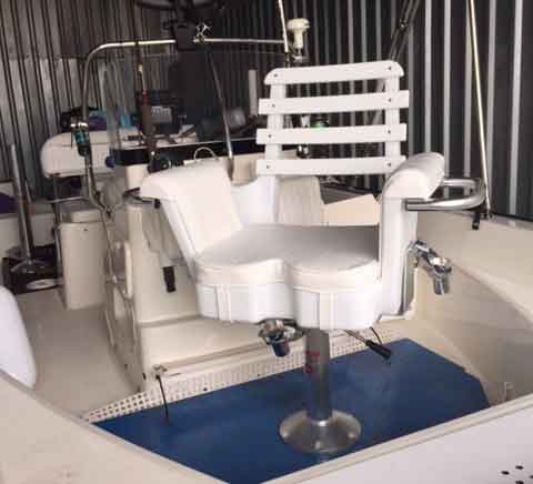

What is the to best way to install a Todd Supreme fighting chair in a 2016 Montauk 170 in front of the console?
With the igloo cooler removed, there's a lot of room to rotate sitting in the seat, and the top of the anchor locker provides a nice flat surface to layout the tackle boxes.
Because the deck has no reinforcement, I mounted the pedestal to a teak plank for stability with DriDeck between the planks and the deck. It works, but will bounce about in a chop.
Is there a better way?

Because of the double bottom hull construction of Boston Whaler boats used for the last 60-years, it is generally not possible to create strong attachment points at random locations in the hull or cockpit deck. Usually an strong attachment point must be pre-designed and prefabricated during the original hull layup by providing appropriate embedded reinforcement material in in the hull below the deck surface.
If no such backing material exists in the location where you want to mount a fighting chair, I don't see any particularly better option than the one you used: mount the chair to some plywood or other reasonably strong material, and spread the load of the chair over a wide area.
It is possible to create small, isolated, strong attachment points for screw fasteners by making your own embedded backing material. The usual process is to drill a small hole, say 0.25-inch, into the deck. Into the hole an L-shaped auger bit is inserted and carefully rotated in order to remove the foam below the deck. The debris is removed from the hole with suction. Then a mixture of epoxy resin and high-density filler is poured into the hole, filling the void created. The resin is allowed to cure. A new pilot hole is drilled. The resin can then be tapped for a machine screw or a self-tapping screw can be threaded into the hole. Use care not to crack the resin or the deck laminate.
In this instance, with the load of the chair spread over a wide area with wooden or other decking above the original deck, the new deck could be fastened in place with a number of screw fasteners into the original deck, located at the periphery of the new deck, and the screws fastened into newly created reinforced fastening points.

I think [the mounting of the fighting chair] maybe okay for now (as it is] without all the labor [jimh] described to screw down.
I sandwiched Dri-Dek between the plywood and deck to cushion any bounce running in a chop. A big guy sitting in this heavy chair with leg leverage against the boat sides feels fairly solid--over 350-lbs of man, plywood, and chair.
Because the Montauk is so light, hooking a big fish might be a fun sleigh ride. And everything is easily removable for cleanup and chair theft avoidance.
