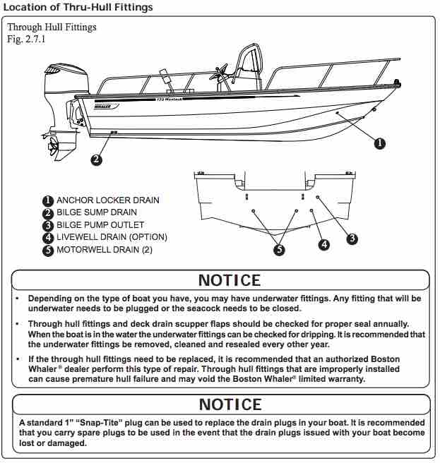

Nota Bene: you can obtain a PDF of the owner's manual from the Boston Whaler website. For example, the owner's manual for a 2017 MONTAUK 170 can be obtained from
http://bostonwhaler.com.s3.amazonaws.co ... l-2017.pdf
On page 2-7 I see a diagram that shows the location of hull drains:
    ANCHOR LOCKER DRAIN
    BILGE SUMP DRAIN
    BILGE PUMP OUTLET
    LIVEWELL DRAIN (OPTION)
    MOTORWELL DRAIN (2)
Boston Whaler 170 MONTAUK Owner's Manual, Figure 2.7.1, DRAIN LOCATIONS
The only drain that would tend to allow water to flow into the cockpit is the bilge sump drain.

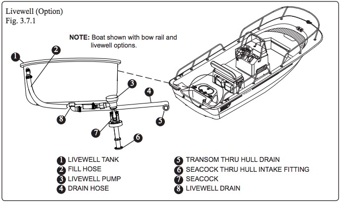

The owner's manual for the Boston Whaler 170 MONTAUK shows the arrangement of the LIVEWELL plumbing in a diagram titled Fig. 3.7.1.
From the Boston Whaler 170 MONTAUK Owner's Manual, page 3-7; live well option plumbing diagram
The livewell option covers over the usual grate that provides access to the cockpit sump. It looks like there is an opening on the starboard side that would allow access inside the housing of the livewell, and that may be the route to accessing the sump area.
The livewell through-hull has a seacock. This would close the drain and eliminate the need to use any sort of external plug inserted into the drain outlet on the hull bottom. Since there is no need for an external plug for the livewell water inlet, it seems reasonable that none would be provided.
Assuming the drain for the cockpit sump is partially covered on the hull bottom, then no plug could be inserted into it, and the drain would be closed by inserting a plug into the drain on the inboard end. Not having a 170 MONTAUK with the livewell option on hand to check, I have to assume that Boston Whaler would have provided some means of access to this area to insert the drain plug, even though it appears that the livewell housing has obstructed access. Boston Whaler has been designing boats for about 60 years, so it would be quite unusual for them to create a situation in which an important through-hull opening could not be accessed.

In the illustration labeled Fig 2.7.1 from the owner's manual for the 170 MONTAUK published by Boston Whaler (and reproduced above) that shows the location of through-hull fittings, there is a note that gives the following advice:
NOTICE--A standard 1-inch Snap-tite plug can be used to replace the drain plugs in your boat. It is recommended that you carry spare plugs to be used in the event the drain plugs issued with your boat become lost or damaged.
