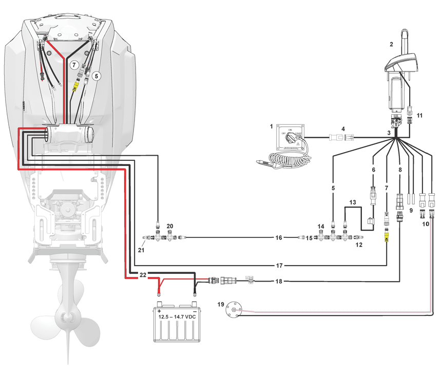

I found this diagram [please see the complete diagram reproduced below--jimh ] in one of you earlier posts. The NMEA-2000 network is powered by the control harness item 13.
When I connect the ICON PRO RPM gauge, do I use the isolating device to keep the power from the gauge isolated from the engine network at point 14 in the attachment?
What about not connecting the power from the control item 2 harness to the network shown in the attachment and insert my current NMEA-2000 network that is already powered by the house battery and leave it at that?

I recommend as follows:
If you want to add an Evinrude ICON Pro RPM gauge to a boat's existing NMEA-2000 network, you will just connect the NMEA-2000 integral drop cable from the gauge to a network-T on the backbone. That's all there is needed with regard to the network connection.
The ICON Pro RPM gauge is not self-powered from the network like many small gauges are. Instead, the ICON Pro RPM gauge must be separately powered by its own power cable. In the wiring harness that comes from the gauge itself, you will find two conductors for power, one has VIOLET insulation and is the positive power, and the other has BLACK insulation and is the negative power. You must connect these to a source of 12-Volt power.
Because the ICON Pro RPM gauge is essentially an engine gauge, it makes good sense to connect its power to the engine ACCY (accessory) circuit that is available from the ignition key switch. That used to be simple, because the ignition key switch actually had a terminal marked ACCY, and you could create a branch circuit for power distribution right from that terminal. Modern rigging is more complicated.
In the case of using Evinrude ICON II PREMIUM EST controls, there is a connector provided in the harness from the controls that gives accessory power. It is shown in my illustration (see below) as CALLOUT-6. There will be 12-Volt power on that cable when the ignition key switch in in RUN or START position. You can use that power to run the ICON Pro RPM gauge.
Now in the diagram the power at the connector CALLOUT-6 is shown powering the NMEA-2000 network. You can decide how you want to power the network in your boat as best suits your situation. I can see two strategies:
--let the power from the engine key switch circuit (CALLOUT-6) power the network; this means the engine key switch has to be ON for the network to get power; or,
--set up a separate power circuit for the network; this means you will have to manually switch that branch circuit to ON to get network power; that can be annoying in actual use.
What I have described is a best-of-both situation. I power my network with a relay, getting the power from an isolated battery not associated with any engine starting circuit. I then use steering diodes to power the relay coil so that relay is activated by either one of two conditions:
--if the key switch is in RUN or START, or
--if I throw the manual network power switch to ON
You are free to choose how you want to power the network.
Also, be cautious about using the ACCY power at CALLOUT-6. I do not know how much power is available there.
Note: Evinrude does make a Y-Cord cable to split the power available at CALLOUT-6's connector so you can attach it to TWO other circuits. From that I would infer that there must be more than 3-Amperes available there. My basis for that is the network is fused at 3-Amperes, so if you can use the Y-Cord to power something else, there must be more than 3-Amperes available. I am GUESSING that probably a total of 5 or 6-Amperes is available. I don't have a specification about that circuit. The battery power to the ICON II PREMIUM EST controls is fused at 10-Amperes, so you can figure that the total power drain off the system via the CALLOUT-6 connector has to be around the net of 10-Amperes MINUS the current used to run the controls themselves.

The rigging for ICON II for a single remote control station with a top mount single lever control for one E-TEC 74-degree V6 engine is shown in the diagram below.
Diagram by BRP; adapted by Jim Hebert. Used with permission.
Ref / Description / Part Number
1 Key Switch (OFF -ON -START) 766554
2 Single Binacle Mount Remote Control 766563
3 Remote Control Harness
4 Key Switch Connection
5 Remote Control to NMEA 2000 Network Connection
6 Accessory Power Out (12 VDC)
7 Remote Control Network Connection
8 Network Power In (12 VDC)
9 Oil Level 1 & 2
10 Fuel Level 1 & 2
11 Trim Switch Connection
12 Terminator Kit 764155
13 Power Node and Tee Kit 767433
14 Connection to NMEA 2000 Digital Display
15 Connection to NMEA 2000 Network
16 NMEA 2000 Bus Cables 2 ft (0.6 m) 765132
16 NMEA 2000 Bus Cables 6 ft (1.8m) 764161
16 NMEA 2000 Bus Cables 15 ft (4.5m) 764162
16 NMEA 2000 Bus Cables 25 It (7.6 m) 764163
17 Backbone Bus Cables 15 ft(4.5m) 587173
17 Backbone Bus Cables 20 ft (6.0 m) 587174
17 Backbone Bus Cables 35 ft (7.6m) 587175
NS Backbone Bus Cable Extensions 1 ft (0.3 m) 587176
NS Backbone Bus Cable Extensions 2 ft (0.6 m) 587177
NS Backbone Bus Cable Extensions 4 ft (1.5m) 587178
NS Backbone Bus Cable Extensions 10 ft (3.0m) 587179
NS Backbone Bus Cable Extensions 15 ft (4.5m) 587180
NS Backbone Bus Cable Extensions 20 ft (6.0 m) 587181
NS Backbone Bus Cable Extensions 25 ft (7.6 m) 587182
18 Network Power Cable, 15 ft. (4.5 m) 587184
18 Network Power Cable, 25 ft. (7.6 m) 587183
NS Network Power Cable Extension, 5 ft (1.5 m) 587185
NS Network Power Cable Extension, 10 ft. (3.0 m) 587186
19 Fuel Tank Sender
20 Connection to NMEA 2000 Accessories
21 Terminator (see Terminator Kit)
22 Battery Cable, 10 ft. (3.0 m) 587205
22 Battery Cable, 15 ft. (4.5 m) 587301
22 Battery Cable, 20 ft. (6.0 m) 587302
(The diagram is originally from Evinrude, but I modified it to better fit the page--it was wider in the original.)

igeorge123 wrote:I do not want to power the network in two locations. The Garmin isolator 010-11580-00 that you have identified in one of you earlier post could solve this concern.
Yes, the GARMIN isolator device will block network power. Note that you can insert the power isolator two different places:
--insert the power isolator into the network backbone to divide the backbone power into two segments, or
--insert the power isolator into an individual device's drop cable to isolated that device from network power, assuming that device is trying to power the network itself.
Posts: 13348
Re: Rigging E-TEC G2 Engines with ICON II EST Controls
Postby jimh » Sat Dec 02, 2017 9:26 am
igeorge123 wrote:What about not connecting the power from the control...harness [at CALLOUT 6] to the network shown in the attachment and insert my current NMEA-2000 network that is already powered by the house battery and leave it at that?
That is a workable solution. There is nothing cast in stone that says the NMEA-2000 network must be powered as shown in the diagram. I think Evinrude just always shows it powered that way because they cannot assume a customer already has installed a network and has it powered.
UPDATE: see my more recent post below about a problem that can occur with network power not being available when the E-TEC G2 engine has power.
