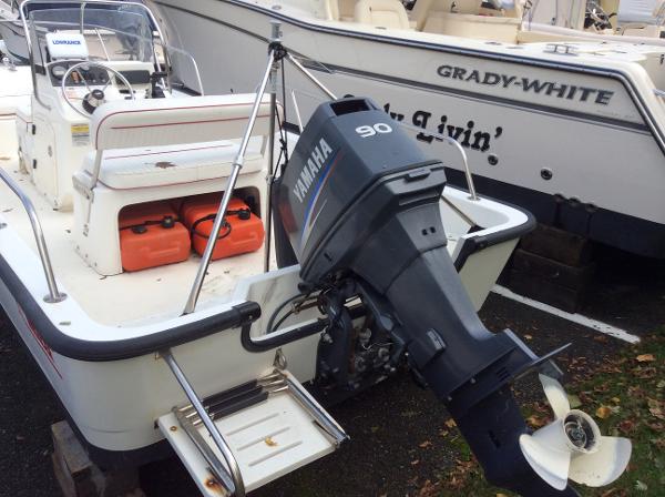

I have a picture of the engine mounted on the transom I'll try to post it here.
Thanks for your answers they were helpful.

You will want to get the propeller spinning up as quickly as possible in order to pull up a skier, so a small diameter propeller with limited cupping and some stern lift (bow lift is a problem when pulling up a skier - you want the bow of your boat to drop as quick as possible). I had good luck with my Yamaha 90HP two-cycle with using a small pitch Powertech SCD4 semi-clever propeller: http://www.ptpropeller.com/content-prod ... amaha.html
A semi-clever will allow the prop to spin-up and get the engine into its maximum torque band as quick as possible. I ran the Powertech SDC4 in a 13-inch diameter x 13-pitch for water skiing and used a standard 15-pitch three-blade propeller for regular cruising activities. You will need to under-pitch the propeller in order to have reasonable results pulling up a skier with that engine on a 170 Montauk. I do believe your underpowered for pulling skiers. Make sure you keep as much weight as you can out of the stern of the boat and have your spotter sit as far forward in the bow as you can.
