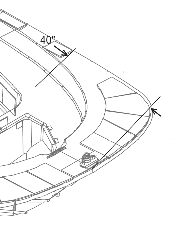

I don't agree with you, though, on the quality of the drawing. Now... I'm just a Chemical Engineer, so I am not as skilled looking at mechanical drawings, but in my opinion, it'd be a really great drawing if there was a reference point that I could measure from to locate all those phenolic boards.
For example, how would I locate C1? Maybe I'm missing something. Maybe this dwg in the owner's manual was cut and pasted from an engineering diagram, and we don't get to see the reference points?
Now, it's possible that my wife is right, and I am actually quite dense.
I was thinking of using a studfinder to see if that might help locate C1.

Thanks guys. Sue at Beacon Marine--big thanks, Sue--sent me a picture of her 190 Montauk forward cleat with a tape measure showing the distance from the textured part of the gunwale. As soon as I pull the boat out of winter storage, I'll try the stud finder or tap methods to see if I can confirm C1, mostly out of curiosity. I don't have forward bow rails, as I have the fishing option with trolling motor controls in the bow.
Re: How to read reinforcement diagram
Postby jimh » Sat Jan 27, 2018 11:45 am
It is great that Sue provided the location of the cleat she installed, but I don't see that this information definitively locates the embedded C1 reinforcement. Was the cleat on Sue's boat installed as a factory option?
Tacky79
Posts: 132
Postby Tacky79 » Sat Jan 27, 2018 2:25 pm
Right - I'm not sure hers are at C1. I was giving that as an example on how that drawing isn't so great, as it really doesn't give you enough data to accurately locate C1, if you wanted to locate that area. I think her cleat is located aft of C1. Her's were not factory options, per my understanding.
Postby jimh » Sun Jan 28, 2018 8:37 am
Until Monday, when you can pick up the telephone and call Chuck Bennett at Boston Whaler Customer Service in Florida, maybe this drawing will be helpful:
190 MONTAUK Location of embedded reinforcement C1, adapted by Jim Hebert from a drawing in the owners manual
I made this drawing from the original. I just removed a bunch of clutter and then moved an existing pair of dimension lines to a new portion of the drawing. I think my drawing will get you close to the location of C1. It took just a few minutes in PhotoShop to accomplish this.
