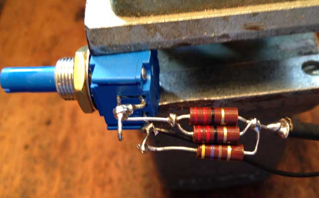

According to some reference material, the resistive sensor on an Evinrude outboard engine that is used for the TRIM position ranges from 10-Ohm (fully up position) to 88-Ohms (fully down position). I wanted to create a variable resistor for bench testing that would produce this same range of resistance. Using a 100-Ohm linear-taper potentiometer and some standard value resistors, I was able to make a sender with a resistance range of 10.6-Ohm to 83-Ohm.

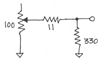

Using a 100-Ohm potentiometer and two fixed resistors, an equivalent of the Evinrude TRIM sensor is created. The 11-Ohm resistor is actually made by paralleling two 22-Ohm resistors.

I began the bench testing with just the 100-Ohm potentiometer connected to (what I though was) the TRIM analogue input. When the outcome was not successful, my first thought was that my simple substitution of a resistive input in the range 0 to 100-Ohm was not going to work, and I must get closer to the OEM sender's range of 10 to 88-Ohm range. After a few calculations and some searching in my low-wattage resistor junk drawer, I found I had some 22-Ohm and 330-Ohm resistors on hand, and I eventually came up with the more complicated arrangement shown above in the schematic diagram. Of course, I did not get to that configuration on the first iteration. I started with just a 22-Ohm series resistance to prevent the sender resistance from going all the way to 0-Ohms. When that did not work, I went through a few other configurations, eventually getting to the version shown above (and not quite the "final" version).
I did this because I thought that perhaps the ICON Pro RPM gauge was being very fussy about what resistance values it would tolerate for the calibration. I wanted to build an equivalent sender that would remain within the stated range, 10 to 88-Ohms, at all settings.

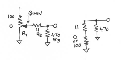

The final version of my trim sensor equivalent changed the 330-Ohm resistor to a 470-Ohm resistor. The final circuit looks like this:
Evinrude TRIM sensor equivalent circuit.
The equivalent circuit consists of two resistors in parallel. On the right side the 470-Ohm resistor is a constant. On the left side the resistance is either:
  1. 0-Ohm + 11-Ohms = 11-Ohms
  2. 100-Ohms + 11-Ohms = 111-Ohms
The parallel resistance is equal
    Rtotal = (R1R1) / (R1+R1)
For the case when the potentiometer is at 100-Ohms, the parallel combination is then
    R = (111×470) / (111+470)  = 90-Ohms
For the case when the potentiometer is at 0-Ohms, the parallel combination is then
    R = (11×470) / (11+470)  = 10.7-Ohms
The earlier version with a 330-Ohm resistor gave values of 83 and 10.6-Ohms, a ratio of 7.8:1 change. The OEM sensor, 10 to 88-Ohms, is a ratio of 8.8:1 change. The 470-Ohm version with 90 and 10.7-Ohms is a ratio of 8.4:1 change, and closer to the OEM range of change.
Three resistors and a potentiometer make an equivalent of the Evinrude trim sensor.
