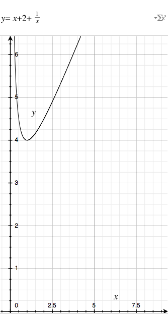

It easier to see if we just plot the denominator and look for a minimum:
Denominator of power equation; power is maximum when this value is minimum. Again, minimum is at x=1, i.e., when the resistors are equal in value.
The outcome is a bit unanticipated: the most power is dissipated in the second resistor when its value is the same as first. At any other value, the other resistor (1-Ohm) dissipates more power. This result is obtained no matter what the resistance of the other resistor is assumed to be.
