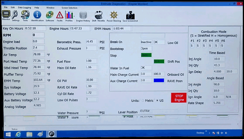

EV Diagnostics v6 Engine Values screen

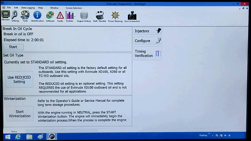

EV Diagnostics v6 Settings screen

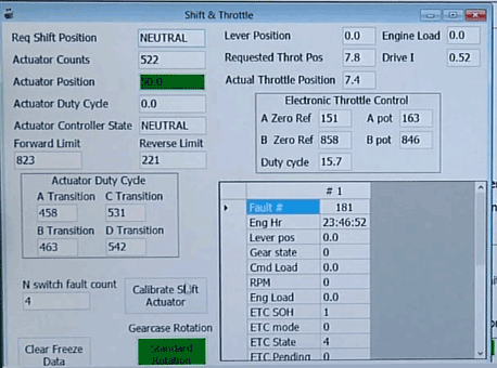

EV Diagnostics v6 Shift-Throttle screen
In contrast to the prior versions of Evinrude Diagnostic software and the electrical interfaces used to communicate with the EMM, this new version represents quite a shift in paradigm. The software package is priced at $350, which is more expensive than prior versions. The hardware interface is a rather specialized device. It is not known if the device contains specialized firmware. In contrast, the prior software utilized standard serial port communication and could work with any number of generic USB-to-serial-port convertors, costing as little as $15. I expect that the new software will not be as flexible about operating with generic devices, nor will the specialized device be low in cost or obtainable from sources other than Evinrude, which has priced it at $554. Finally, an adaptor cable will be needed to interconnect the CAN bus adaptor to the boat network. This cable is moderately priced by Evinrude, $44, and it seems unlikely that much savings could be had by fabricating one.

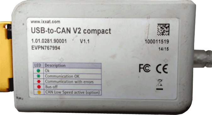

The connection for the EV-Diagnostic 6 software to the E-TEC engine is not made directly; the two devices are connected to a NMEA-2000 network, and they communication over the network. Evinrude provides its dealers with the interface device, shown below:
IXXAT Interface for Evinrude G2 Engines
The interface connects to the terminal or computer executing EV-Diagnostics V6 under Windows via a USB interface (partially seen on the right in the above image). The interface connects to the network via a DB9 connector and a special DB9-to-DeviceNET Micro C connector (partially seen on the left in the above image). It is not known if the interface provides opto-isolation of the electrical interface at the network side, but that would be typical for a product that connects to NMEA-2000 networks.

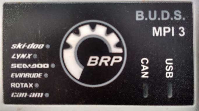

In using a network connection for the engine interface on outboard engines, Evinrude is perhaps the last division of Bombardier Recreational Products (BRP) to adopt this method. Other BRP companies like SkiDoo (snow machines), SeaDoo (personal water craft), and Can-am (three-wheel motorcycles) were already using this method. The abbreviation B.U.D.S. may mean Bombardier Universal Diagnostic System. The front panel of the interface reflects it use with many different BRP products:
The same interface can be used with several other BRP E-TEC engines, in addition to the outboard engines.
