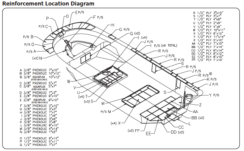

My Montauk 150 manual is very helpful and shows the size, type, and general location of all the glassed-in reinforcement pads. But the location is not very specific.
A Whaler Customer Service Representative suggested using a stud finder to locate the pads I'm interested in. So I tried that. My problem is that I can't get signals to repeat reliably enough for me to be sure I've properly located a pad. And some pads seem to be in places the diagram in the manual suggests there is no pad.

I believe you are looking for embedded material in the hull, as shown in this diagram from the 2016 150 MONTAUK owner's manual:
Fig. 1. 2016 150 Montauk hull reinforcement location diagram from owner's manual
You can deduce the approximate location of the embedded material from the drawing, which appears to have been made to scale.
