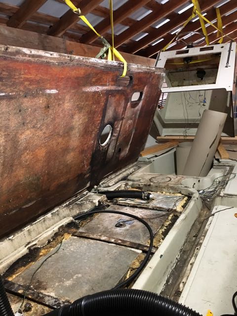

I was finally able to remove the rigging from the console and remove it from the deck. I slid it to the bow and removed the guts so I can sit in the forward well with easy access to rewire.

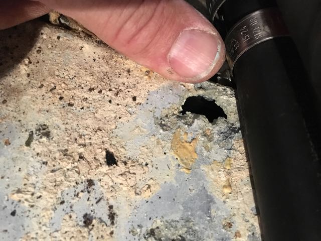

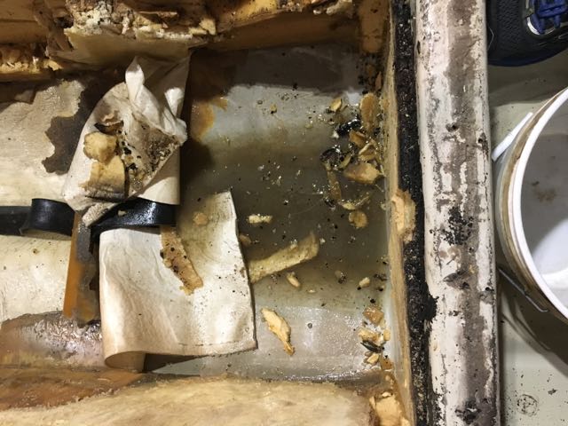

With the Deck lifted, I finally had easy access to the tank. The tank was replaced in 2007 with a brand new one from Florida Marine Tanks. I suspect the work was done poorly given the premature failure. In the photos below, you will see many surface corrosion holes and plenty sludge consisting of Fuel and Water (nearly 2-gallons plus whatever is still in the foam).
I don't think the yard that replaced the tank pulled all the existing foam and replaced with new foam, given the various types of foam I'm seeing and clearly different layers.
What led to the tank corrosion?
I've included a few photos of the bonding wire which I suspect wasn't done right but I'm no expert.
I did notice that there is a clear line of holes that ran under the fill hose. This was something I had to replace initially as the hose had collapsed and would no longer easily allow the tank to fill. It's probably a factor only in that it was sitting on the tank and probably held moisture against the metal. I found pitting elsewhere and a smaller hole near the pickups. All of the damage was on the surface from what I can see.
Fig. 1. Deck and Console removed

Fig. 3. Fuel and Water sitting in the Tank Cavity

Was the filler neck grounded to the tank? Was it a wire filled marine grade fill hose?

Yes - the one that was there when I purchase the boat was marine A-2 and grounded. I don’t know if the wire in the hose was grounded but the fill neck was.
I suspect the water was able to sit between the pipe and tank allow crevice corrosion but there were several holes in other areas including one on the side.
I need to find an install method without foam. Not quite sure how I’ll brace the tank without foam.

Boston Whaler boats with aluminum tanks were all installed with foam. They last as long as 20 to 30-years, or longer. I'm guessing your problem with corrosion was electrolysis from poor grounding. You might think it could be the wrong foam was used on the tank replacement but not sure how that could cause rust.
Earlier this year I installed new ground wires and fuel lines on my 1986 boat. It had original fuel lines and the fuel tank is original. No problem with corrosion under the fuel fill line. Check my posts for Jim's advice on the wire to use and the connections to make for the grounding of the tank.
