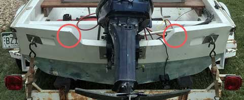

Fig. 1. Transom of 13-footer with desired new location indicated by red circles
Do I need to move these stern eyes to their normal location (red circles) or can I keep them where they are?
Based on the wood locating diagram neither of these locations have wood. I would prefer to keep them where they are to avoid having to fill in two big transom holes only to make two more, but if it's necessary so be it. You can see in [Fig. 1.] that the stern eyes are currently next to the hand grips. Normally I see them in top corner of the transom cut (where the red circles appear in Fig. 1).

Assuming the existing eyes are through bolted they should work just fine were they are.
Watch them to make should nothing weird is happening after use.

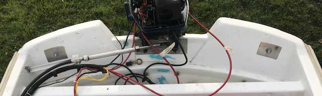

Fig. 2. Transom of 13-footer with through-bolted stern eyes.
Yes, [the stern eyes on the boat now] are through-bolted.

The stern eyes appear to be solidly installed. I think the location they are in now is probably better for use as a tie-down to the trailer.
For a towing bridle, I would get a metal ring about 2-inch diameter. Splice two lengths of rope onto the ring. Make the length of those two ropes just long enough to reach the stern eye bolts and hang down very little behind the engine midsection. If you want a clean installation, make an eye in the rope ends and attach to the ropes to the eye bolts with a small anchor shackle. The tow line attaches to the ring, in whatever fashion you desire.
The reason for keeping the ring close to the transom is to avoid getting too much leverage on the transom if the tow line were able to pull directly on one of the stern eyes. With the stern eyes so far off keel centerline, I think the tow line, if able to work directly on the stern eye, would tend to have more leverage on the boat and would perhaps start to skew the boat course.
In the 1980's--when we were all much younger and smaller--to water ski behind a SPORT 13 with a 25-HP two-stroke-power-cycle engine was possible for young adults ages 25 to 35 of normal weight. To pull up younger children should be well within the capabilities of the boat.
