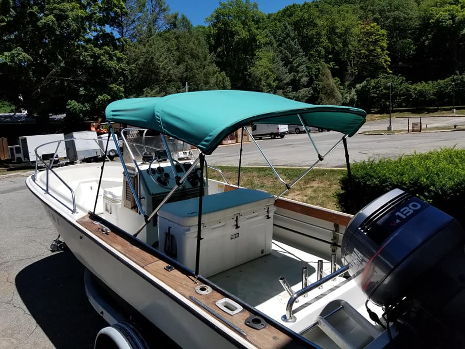

The Bimini top is too low for me. You can't drive standing up. A quick measurement showed it's about 45-inches tall.
Do you happen to know the height of the Bimini top typically used on Outrages? I can't seem to find measurements. The tallest stock Bimini I can find on the market is 54-inches tall, but perhaps the Mills Bimini is custom built and a lot taller?
Whaler 18.jpg (101.54 KiB) Viewed 8211 times

I have a Mills bimini on my outrage, unfortunately it is still covered for the winter. My son is 5-feet 10-inches and stands under it with plenty of headroom.
On a different topic: can you post pictures of the stern layout on your boat?
From the little that can be seen on the picture you posted the stern layout looks interesting.

Cut the front and middle poles a little shorter. Slide the front and middle, smaller, poles up higher. Lengthen the rear straps and tighten down the front ones. Should give you more height on the top for now.

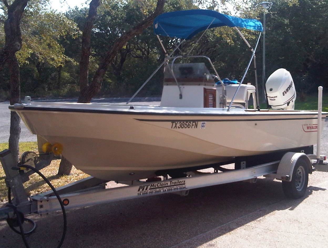

I don't have access to measure mine right now but here is a picture. I'm 6' and can stand comfortably under it. I believe mine is the Mills Sun Top, it only has the one bow. [Looks like a Flying Top—jimh] It used to be on Gambler, I bought it from Dave about 5 years ago.
Sun Top 1.jpg (152.17 KiB) Viewed 8151 times
