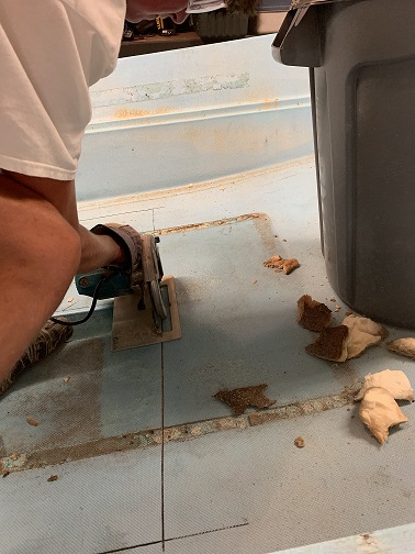

Once we got the boat back we removed the console as well as the old steering cables, wires, and fuel line that had been left in the boat. As a perk, we noticed the boat came with a unused Moeller 22-gallon fuel tank. We removed the corroded drain line. Based on the softness in the deck in some places we knew there was going to be some work ahead.
We drilled a few holes in the deck, starting towards the transom and went towards the bow until the foam we were drilling into was no longer sopping wet. We then proceeded to cut the floor and remove it in panels, removing pound after pound of soggy foam along the way.
We finally found some good lamination on the floor along with dry foam and that is where we called it for today. I am sure that we will be asking lots of questions. We will keep this post updated with progress and pictures as we go. Neither of us has ever re-furbished a boat before. We are both rising sophomores at Clemson.
