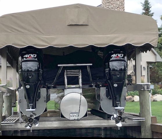

Here is a modern "pontoon" boat as seen on the Indian River in northern Michigan:
Fig. 1. A tri-hull deck boat with 800-HP: not your grandfather's pontoon boat. Photo credit: Con B.

800 HP and four blade propellers look mean. Those propellers look almost like cleavers, are they? Did I notice some cladding on the outer tubes giving them a shaped bottom?

I think the propellers are REVOLUTION4 propellers.
Good observation on the hull shape being modified from the round tube on the running surfaces.

Goodness gracious. I wonder what it would be like to be on that when it’s WOT?

Holy smokes that is just not right. I noticed that the center pontoon is lower than the outer on the water. I bet that thing looks funny going 80 mph across the the lake.

[The speculation the propellers are REVOLUTION4 propellers is] correct.
The outboard pontoons have lifting [strakes]. The center pontoon is a larger diameter and is 1.5-inch lower [than the outboard pontoons] for performance.
Greg’s boat was used as an anchor for my Montauk today at a Burt Lake sandbar.
The boat runs 75-MPH on a good day across the lake.
