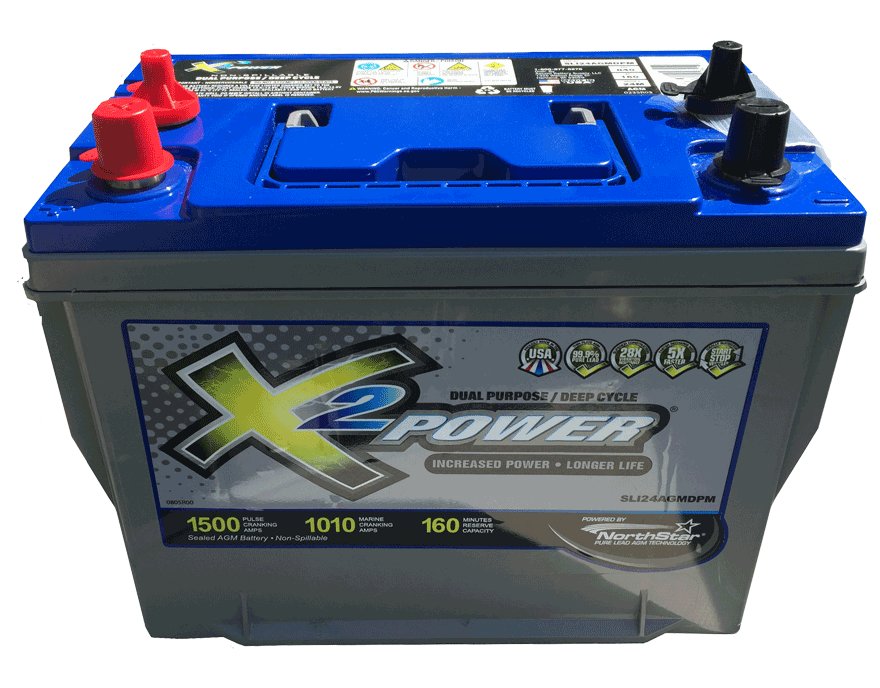

Fig. 1. The Group 24 AGM X2 Power Battery.
As seen above, the battery label declares "THIN PLATE AGM 99.9% PURE LEAD" and "POWERED BY NORTHSTAR PURE LEAD AGM TECHNOLOGY"
