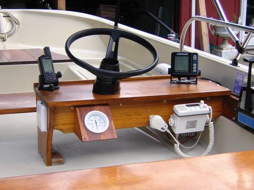

Postby jimh » Tue Sep 03, 2019 8:10 am
Fig. 1. Tachometer gauge mounted in sloping wood enclosure.
The illustration above shows how I added a tachometer gauge to the small flat console of a SPORT 15.
hermit
Posts: 20
Joined: Wed Jul 24, 2019 12:24 pm
Re: Gauge placement on 1972 Katama console
Postby hermit » Tue Sep 03, 2019 8:40 am
Thanks Jim, that gauge installation is nicely done. At least the top of the Katama console provides ample space if one chooses to use it.

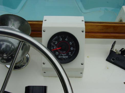

Postby whalerron » Sat Sep 14, 2019 2:14 pm
Katama console tachometer box
tachbox front.jpg (58.95 KiB) Viewed 9920 times
I had a 1969 Minot which uses the same console as the Katama. I built a box out of Starboard which I mounted to the top of the console. I then mounted a tachometer in that box. You could lengthen the box to allow for more gauges.
