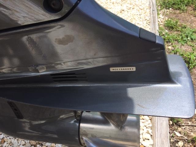

I noticed the lower unit had a unique serial number on the port exterior and that is a great idea, a long time coming. [To have serial numbers on gear cases] may deter some thefts.
Fig. 1. Yamaha puts a serial number on lower unit of F300 NCA model
Yamaha Lower Serial #.JPG (42.05 KiB) Viewed 12265 times

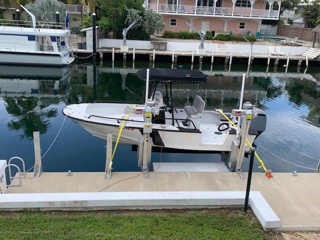

Fig. 2. Boat on lift.
21 on Lift.jpg (56.28 KiB) Viewed 12265 times

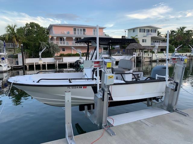

Fig. 3. Dive Door removed for Hurricane Prep
21 Bston Whaler 3.jpg (69.73 KiB) Viewed 12114 times

Also, I like the serial numbering of the gear case, too. Does the gear case number match the engine serial number?

Thanks Jim, the lower unit serial number is unique unto itself, however in the Yamaha computer system entering the engine (powerhead number) or this new lower unit number ,reveals the other one and shows my name and address as owner and my Extended Warranty info.
