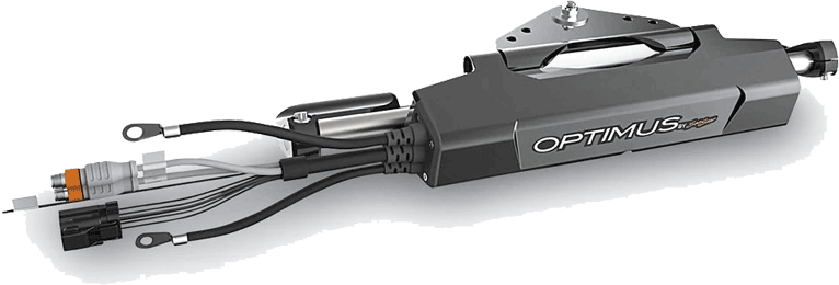

In 2020 there may be a new option to hydraulic steering: all-electric steering. The engine actuator will be operated by electrical power. It will be wired to the boat's battery. The control of the actuator will be via a digital link to an electric helm control, to which you will connect a conventional steering wheel.
Fig. 2. Sea Star Solutions electric actuator, said to be available in 2020.
The steering control will be provided with the engine speed from a sensor. The steering control will adjust the steering system number of turns lock-to-lock to suit the engine speed and expected maneuvering at that boat speed. This system can also be integrated to auto-pilot control. There was a press release about this in February 2019:

(Litchfield, IL – February 14, 2019) – SeaStar Solutions, now part of The Dometic Group, and the leader in marine steering and control systems, is ushering in a new era in steering and control with the introduction of their new SeaStar Optimus Universal Electric Steering Actuator. Incorporating proprietary technology and several new components designed and manufactured by SeaStar, this new actuator is built exclusively for use with their Optimus Joystick and Electric Power Steering Systems.
About the same size as the SeaStar Tournament Cylinder, the Optimus Electric Steering Actuator mounts directly on the outboard in place of the present hydraulic cylinder. With its powerful drive train, integrated proprietary position sensors and embedded electronics, it eliminates the need for separately-mounted hydraulic actuators used in the Optimus Joystick and EPS systems. This means no more Pump Control Module, no more hydraulic pump, no more hoses, hydraulic cylinders and fluid, and no more purging the system.

With the new Optimus Electric Steering Actuator, the electronic helm signal goes directly to the actuator which instantly moves the outboard. The “brains” of the Pump Control Module, including ECM, rudder position circuit and CANbus communication, have been transplanted into the new Optimus Electric Steering Actuator itself. Steering power is delivered by a proprietary high-torque high-efficiency brushless DC electric motor, designed and manufactured by SeaStar, and a patented compact roller-screw drive system, also a proprietary SeaStar design. Both the motor and power train reside within the steering actuator.
In terms of steering performance, skippers will sense a difference in handling. Steering response will be immediate, smooth and precise, thanks to this robust, industry-leading drive train that provides unparalleled performance and system rigidity when needed most.
Programmable steering settings, including adjustable speed-sensitive lock to lock turns, adjustable speed-sensitive wheel effort, and speed-sensitive rudder angle limits to ensure safe steering, continue to be available, now without the need for any extra componentry.
Installation of the new system is a snap, with just three CANbus connections plus power. Twin, triple and quad outboard installations will be set up similar to the present design, with Optimus Electric Steering Actuators controlling adjacent outboards via tie-bars. In addition, the new Electric Steering Actuator will interface with compatible autopilot systems in the same manner as the present Optimus systems. SeaStar’s SeaWays Autopilot and SeaStation GPS Anchoring functionality are also built in.
The SeaStar Optimus Electric Steering Actuator exceeds all applicable marine standards, including NMMA, ABYC, CE and SAE electrical and environmental requirements. The actuators are maintenance free, except for regular greasing of the steering ram via installed zerk fittings. Over 100,000 hours of rigorous testing during development assures safe and reliable performance under harsh salt and freshwater conditions, all in keeping with SeaStar’s proven reputation for superior quality.
The new Optimus Electric Steering Actuator will be available in late 2019 to OEMs installing Optimus Joystick and Optimus EPS systems. For more information on SeaStar Optimus systems, or the many products SeaStar Solutions offers to boat builders and boaters, please visit http://www.seastarsolutions.com.

In comparison to hydraulic steering, the Sea Star Solutions electric steering has some advantages, notably freedom from oil, oil lines, and purging. However, being electric the steering system relies completely on the integrity of the attached battery to supply the electrical power to operate the actuator and the control helm. Loss of electrical power from either a failure of the battery or a circuit fault that causes a fuse or circuit breaker to open would probably produce a total loss in steering control.

In the event of power loss, would it be a reasonable assumption that the steering would be "frozen" at its last position? That might be less dangerous than a system which relies on its helm to provide ANY directional control.
