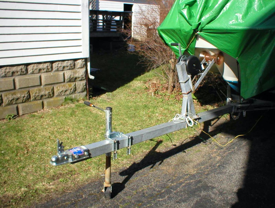

In a REFERENCE article series on TRAILERING, a very good illustration of a trailer tongue extension was provided by contributor Chuck Tribolet, a crafty engineer (who unfortunately passed away several years ago). His modification is seen below:
The right-hand portion of the extension fits into the existing trailer frame. When at the launch ramp, if even more extension is desired, two bolts can be removed, and the tongue can be extended further, and the bolts reinstalled.
As seen above, the extension and the original trailer box-beams are joined by using a smaller box-beam that telescopes inside the original beams and has a considerable span to bear the stress and load.

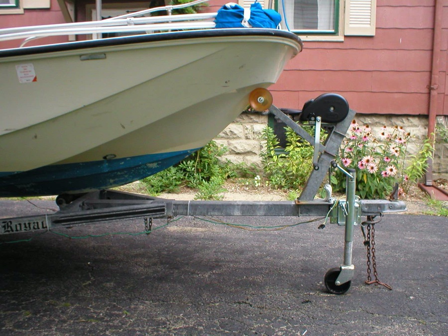

On 2 of my 3 boat trailers I have modified the tongues to allow the trailer to set further down the ramp or keep the tow vehicle from making contact with the salt water.
On my Royal branded galvanized trailer I purchased a stock tongue that was longer at a local trailer supply house. I removed the existing tongue, reinstalled the winch post, trailer jack. I installed a new coupler and additonal trailer wiring. I added ~36" to the original LOA. This boat was stored outside without a limitation on space.
Original trailer tongue:

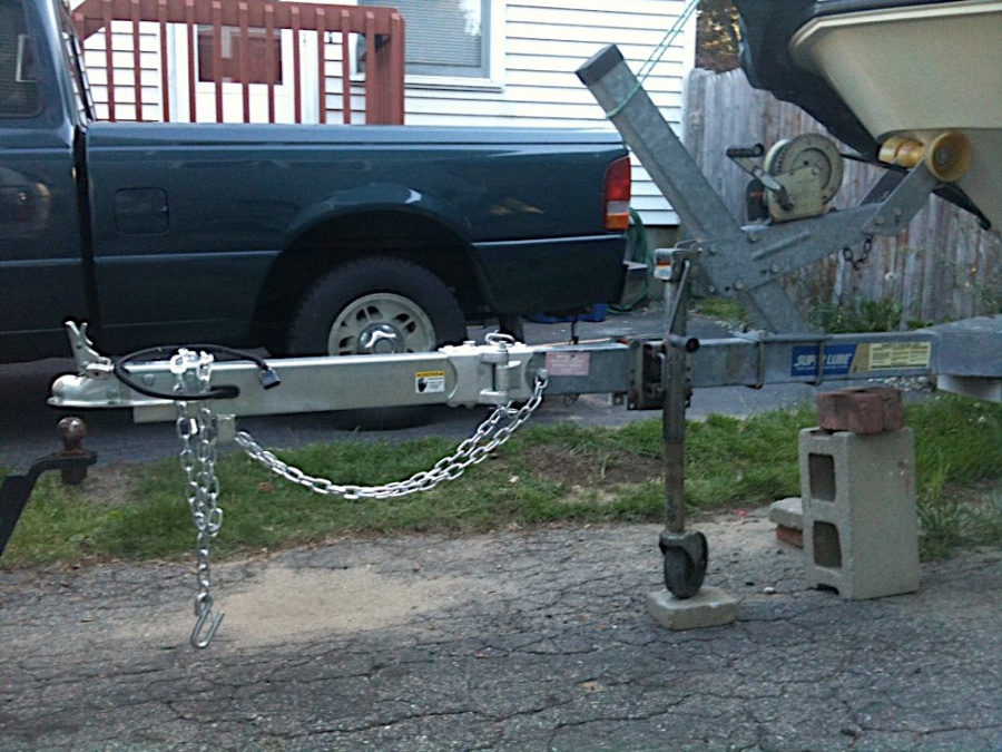

New Tongue Installed:
On my Load Rite trailer, I purchased a 3' tongue extention with hinge kit. I cut off the welded coupler and bolted on the kit. I added a 3' trailer wiring harness extention. This boat was stored in an area with a space limitation.
Note - Fulton does not show this kit (hinge and tongue included) available any longer. If one wants to go this route, purchase the hinge itself from fulton and the tongue from a local boat trailer supply store. Also needed will be the longer safety chains and trailer harness extention. It is a DIY effort that just takes a little planning, part sourcing and some standard tools.
