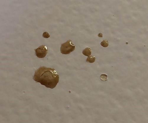

Q1: What are these small brown liquid deposits?
Fig. 1. Extreme close-up view of brown liquid deposits.
fiberglass problem small.jpg (45.42 KiB) Viewed 17332 times
Some very tiny deposits are surfacing under new gel coat. I have no recollection of any preexisting damage or repair at this spot. There is a tiny pin hole under each deposit. The liquid feels like a foam styrene goo of some sort.
I can clean them up, but they reappear the next day.

Please clarify what is meant by the expression "new gel coat."
Q2: Did you recently apply new polyester gel coat resin to the hull?
Q3: If so, what was the surface that the new polyester gel coat resin was applied to?
Q4: How was the surface prepared?
Typically, brown goo is uncured resin. It is typical on Boston Whaler boats that are quite old to still have some uncured resin still in the hull, even on boats made 30-years ago.
Q5: How old is the hull?

To me that looks like moisture that is under the gelcoat, probably moisture from dew, humidity and rain that got sucks up through the pin holes and cracks in the gelcoat. The change in temps through the days and night helps suck the moisture up in there.
Once in there it breaks down the resins and comes out in form of brown vinegar smelling ooze. If it is smells like vinegar then that is what it is. It is not structurally bad but just looks back.

I agree with Jim, uncured resin escaping.

To test the theory of resin mixing with water, take some uncured resin and mix with water. Wait a few days and report what happens.

If that is new gelcoat then, I think it is uncured gelcoat too. You may want to do a small gelcoat repair on that area. But if left alone I don't think it will hurt anything either.
You could try putting a little heat on it to help it cure underneath. Polyester resin likes heat to cure and even uncastilized resin will cure over time on its own left alone.

Sorry for the delay in responding. Yes this is new gel coat over old gel coat that was sanded down.
It does seem to be more active if the hull is in the sun vs in the shop. In fact I never noticed it until I rolled the hull outside for few days. It's an 1963, 13 foot classic. I'll be doing a few small gel coat patches due to over sanding the new gel coat down to the glass. THANKS !

Based on the one photo the gelcoat that has been applied is very bumpy. That indicates to me that it was not applied properly. A final gelcoat finish via spray application technique should not be even minimally orange peeled. The reason for this is a gelcoat finish applied topically as a refinish topcoat will need final wet sanding and buffing out. The more irregular the surface to be wet sanded smooth the more irregular the gelcoat finish depth will be due to the need of sanding off the high bumps. All finishes; paint, gelcoat or varnish; need to have a certain millage of finish depth for visual acceptability and specified use durability.
As to the bubbling of stuff from the gelcoat you applied. I do not disagree that it is uncured resin from the gelcoat finish you applied as long as your statement about the surface area you applied it to had no prior repairs etc- just plain old existing fiberglass/original well sanded gelcoat is accurate.
If the gelcoat is emitting unfinished resin during the curing process after application that is not normal at all. It either means the gelcoat was not mixed properly prior to application or the product is defective. Once gelcoat is mixed and sprayed properly you will not have unfinished clear resin bubbling from the finish at all. It has been a very short period of time between the application of the gelcoat and you reporting the finish bubbling. It's still in the curing stage.
