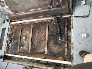

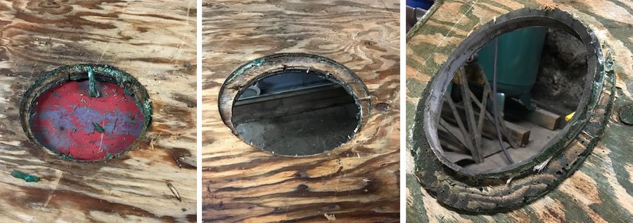

The deck lids were pulled after removing about six inches of snow. All three lids showed signs of soft spots. I peeled the skin off of the main center lid. I took pictures of the results, and I am quite surprised at how much excess resin filled voids of access ports.
Fig. 1. Three views of wood reinforcement from the cockpit center deck section. On left is the wood side at the fuel access. Center and right are the aft access hole, wood side and skin side.

I am somewhat amazed that you could separate the wood backing reinforcement from the fiberglass molded deck sections, leaving the wood apparently very intact. The bond between the wood and the fiberglass deck must not have been very strong, and the wood must have been in reasonably good shape in order to come off in one piece. My impression from reading accounts of other renovation projects involving the deck and its reinforcement wood is the process of separating them is tedious and involves a lot of work with a chisel.

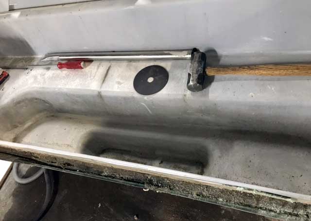

jimh wrote:I am somewhat amazed that you could separate the wood backing reinforcement from the fiberglass molded deck sections, leaving the wood apparently very intact. The bond between the wood and the fiberglass deck must not have been very strong, and the wood must have been in reasonably good shape in order to come off in one piece. My impression from reading accounts of other renovation projects involving the deck and its reinforcement wood is the process of separating them is tedious and involves a lot of work with a chisel.
I was also pleasantly surprised. On the 1995 Sentry 19 boat I restored, the wood was wet but still well bonded to the skins. I used a piece of 5/8-inch steel tubing and hammered one end flat, forming a wedge. Using that tool, I was able to drive the wedge under the skin and wood which did a good job of separating.
On the repair of this lid I will use wood but everywhere a screw passes through I will cut away the wood core and fill it with thickened epoxy. I plan on documenting this process. I will also vacuum bag the lid and new wood together and document that process since it is by far a better method of ensuring good adhesion.

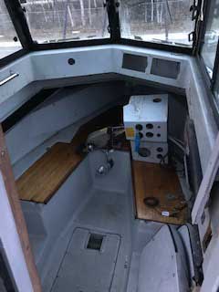

One thing to know is the cabin is fairly small compared to the size of the boat. I will attach a picture of what it looks like with most of the rigging being pulled out.
Fig. 3. Cabin Derigging.

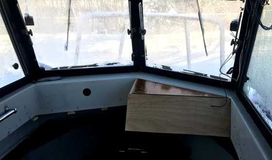

I started mocking up the new dash yesterday. So far this is just the right hand side. I’ll start the left side when I can get to it. When I get it mocked up I’ll epoxy it together and start making fillets with thickened epoxy and start sanding. Then it’ll be time to glass and fair the dash insert and then glass it in place. More to come later.

Re: 1986 FRONTIER 25 Rebuild
Postby biggiefl » Mon Feb 03, 2020 11:09 am
Would you just replicate the one you made as it looks like the dash is the same on both sides?

I think having the left side built like a tray would be better than a full dash spanning the cabin. The forward "V" shaped section makes it a difficult area to work with so I'm thinking a tray would be better than a glove box. I could mock something up and see if it looks right and makes a good use of space.

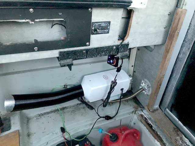

I need a solid chunk of time to work on the boat since it takes some time to heat up the cabin to work in. Here is a picture of the temporary heater installation. It keeps the cabin nice and warm at about half power.
Fig. 6. Temporary hot air heater in cabin during work.

A tray with a lid(plastic or wood) would work well.

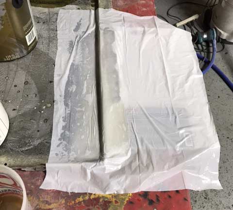

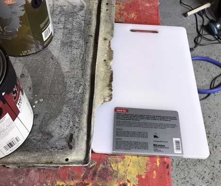

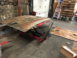

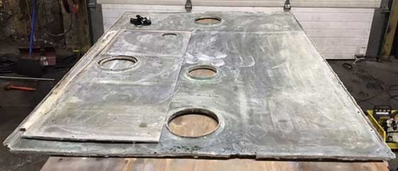

I was able to do some more work on the deck lids today. Most of the time was spent grinding the underside of the top skin. The areas where an inspection port was molded needed the most grinding. Some fiberglass repair on the forward most lid where a thin flange was molded was also done.
Fig. 7. Underside of laminated deck cover.
Fig. 8. Cutting board to support under flange.
Fig. 9. New glass epoxied down.
Plastic was used on top of the new glass to put pieces of wood down to hold the glass in place.

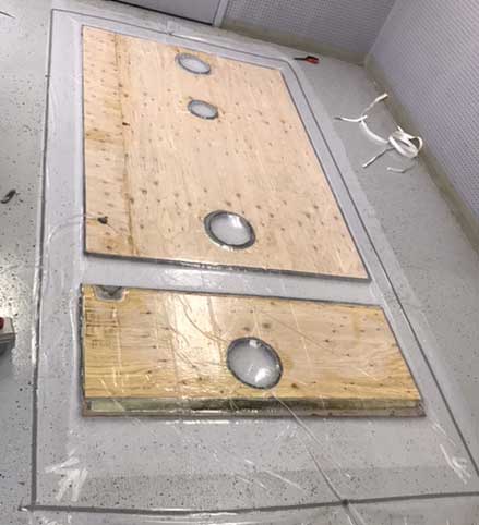

I laminated the first layer of ply onto the existing top skin and vacuum bagged the assembly down to the flat concrete. It turned out well and is quite straight. The little amazon vacuum pump ran all night and didn’t overheat. Progress is slow but coming along.
FIg. 10. The deck reinforcement being adhered with a vacuum bag technique.

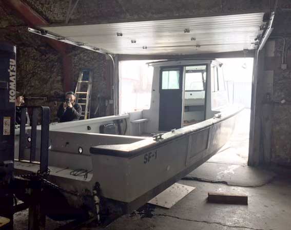

Fig. 11. Getting the FRONTIER 25 into the shop was difficult. It barely fit.

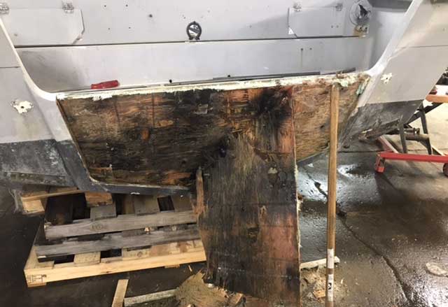

Fig. 12. The wood reinforcement in the transom wasn’t rotten but was quite wet.
