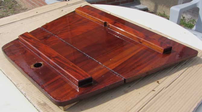

Oldslowandugly
Posts: 719
Location: Queens NY
Re: Sport 15 Making Replacement Anchor Locker Hatch Cover
Postby Oldslowandugly » Wed Mar 18, 2020 8:54 pm
[The illustration below shows] where [the project to create a replacement hatch for the SPORT 15 has progressed] so far.
Fig. 1. New reproduction hatch for SPORT 15.
The braces underside keep the hatch located nicely. It can't slide out in rough seas. I had to fill in the original hole with the plug I cut for the new hole.
Postby jimh » Thu Mar 19, 2020 8:51 am
What method was used to join the two pieces of wood that form the hatch?
Oldslowandugly
Posts: 719
Location: Queens NY
Postby Oldslowandugly » Thu Mar 19, 2020 10:03 am
The two pieces of the hatch are not joined.
The hatch was made by Specialty Marine as a single piece to fit the Montauk 17. I cut it down to fit the Sport 15 well. Then I cut it to make a folding hatch.
There are two Perko hinges on the other side. The larger piece stays in place while I lift the front to put fish in. That is why I made a new finger hole and filled the original hole.
The varnish was still tacky so I took a picture of the bottom first. When this rain passes, I can put more coats on the top side. Then I will take a picture of that and you will see the hinges.
When I purchased the hatch it was a closeout sale as a "blemished" item. That worked for me as I knew I would be cutting it anyway to make a folding hatch. I just checked the site and they must have all sold out.

The Sun came out! Here is the top side with the hinges. You can just see the old hole that I plugged. That used to be the center so you can see how much I cut it down by. The 17-footer hatch is about five inches wider than the 15-footer hatch. Length was almost the same.
New hatch top side

The almost finished hatch.
The stainless steel ruler [seen above screwed onto the hatch ] was cleaned up and varnished.
The little wood blocks are oak parquet flooring. The [opening front] hatch rests on them in the open position.
