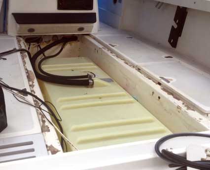

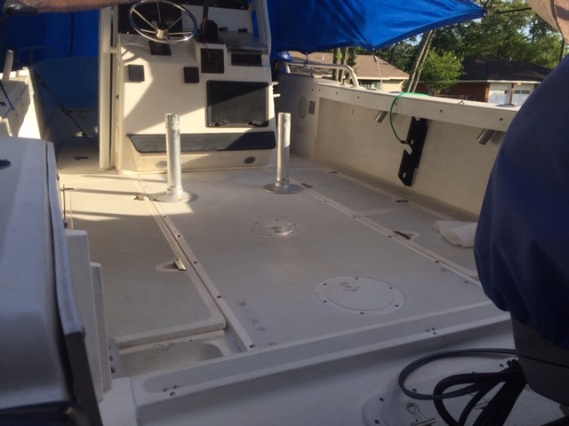

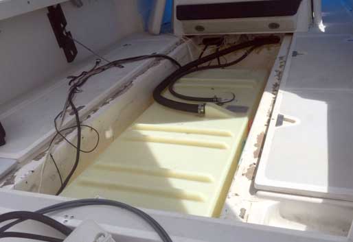

Fig. 1. The fuel tank cavity cover removed.

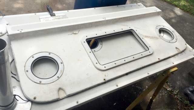

Fig. 2. A view of the original fuel tank still in place.

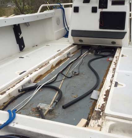

Fig. 3. Another view of the aft end of the original tank.

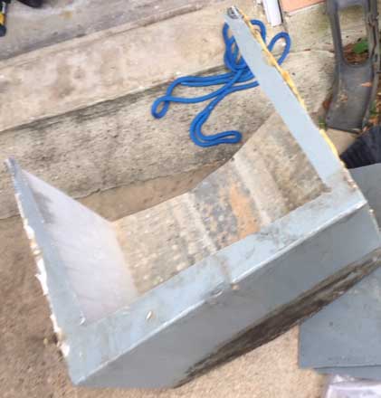

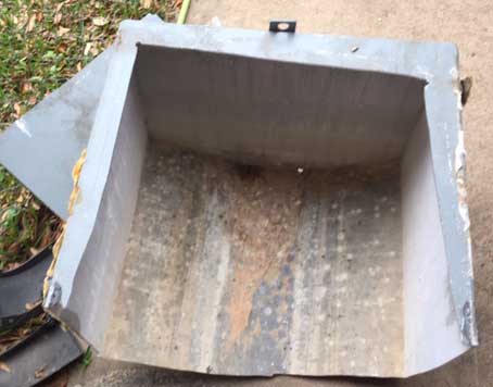

Fig. 4. Cut up portion of legacy tank

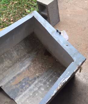

Fig. 5. Cut up portion of legacy tank
Fig. 6. Cut up portion of legacy tank

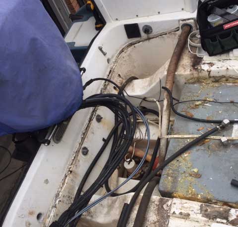

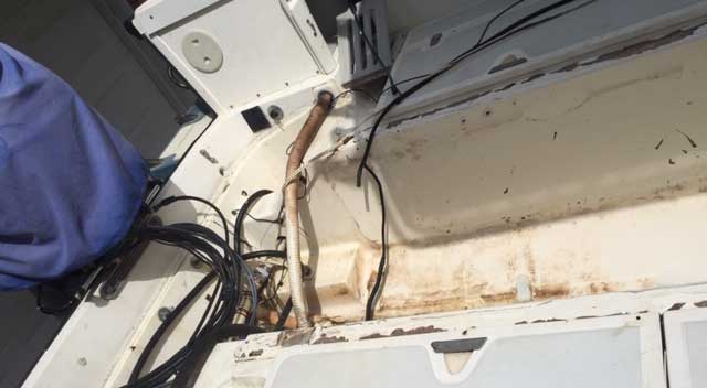

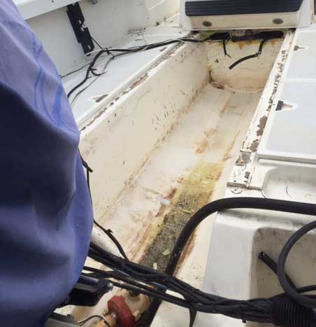

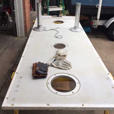

Fig. 7. Portion of cockpit deck, removed from boat.
Fig. 8. Fuel tank cavity with original tank removed.
Fig. 9. Fuel tank cavity with original tank removed.

[To remove fuel from the old tank] I used a brass tube connected to fuel hoses and connected to a automotive fuel pump. The pump emptied the fuel tank. I did this a good while ago. I was hoping [the old fuel tank] would just have water in it. But it was bone dry when I cut into it.
It was extremely windy on the day when I started on the project, so I didn't need a fan [to disperse gasoline fumes]. I drilled a big hole in the back of the old fuel tank. I didn't smell [gasoline] fumes. I used a sheet metal bit and went slow on the drill. No gasoline fuel smell. I cut across the back, still no smell. So I drilled more holes and cutout a square panel.
The tank was completely dry on the inside. Again it was very windy and if [I had] smelled gasoline fumes I would have stopped.
Plan B was to use an air grinder to cut, suck out any remaining fuel, and then let the fuel tank air dry.
One reason [the fuel tank] was empty was the corrosion in the very [aft] of the tank. I cleaned out the [the boat by] filling the bilge full of soapy water and draining. I did this several times. Soapy water probably leaked back into the tank and then drained out again.

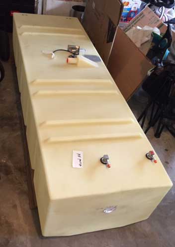

[The new tank] is a 111-gallon Moeller. The side angles matches the tank that came out. This also matches the cavity bottom angle., and the new tank filler lines up with the deck plates. Thank god for all that matching up.
Original plan of building a shelf is not needed. The bottom of the tank locker is actually flat. So I am going to build up with cut [rubber] mats. The whole tank will sit on rubber mats.
The installation plan is to let the tank sit against the rear bulkhead against rubber mats. Four aluminum flat strip hold downs will go on top of the tank. They also will have rubber under them.
Poly tanks will swell when they have fuel in them. The last bracket that screws into the front of the tank that will be installed after I put fuel in the tank. Then the deck will go back on.
I think the hard part is over. I have installed tanks before in Boston Whaler boats, so I hope things will get better. Cutting that tank up sucked. I wish I had taken a picture of the lift set up. It consisted of eight 4x4's, wood blocks, two concrete blocks on end, and a cable crank lift.

Fig. 10. The replacement fuel tank, a 111-gallon model made by Moeller, and a stock item.

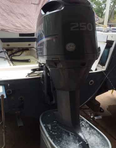

I put 10-gallons of no-ethanol fuel [into the fuel tank] to help the fuel tank expand before I secure it. The boat will never get ethanol-gasoline blended fuel again.
Fig. 13. An engine being run with the water pickup in a tub of water, illustrating the operation described below in the text.
I flushed out the old gasoline. I primed the fuel lines and reconnected. Then I ran the engine off the new tank to test everything. That Yamaha really liked the no-ethanol gasoline fuel.

Did you have to cut the original fuel tank into pieces in order to remove it?
It looks like you cut off the entire top of the original fuel tank. Was that done while the tank was still in place in the fuel tank cavity in the boat?
NLA01
Posts: 170
Re: Replacing fuel tank in 1995 24 Outrage
Postby NLA01 » Thu Mar 26, 2020 11:56 am
Yes I cut the tank up in the boat to be able to remove it. The tank weight was 200-lbs. I use a 4x4 across the gunwale with a cable winch and lifted the tank up; then I cut it up while up in the air. The tank was completely dry with no fuel or fumes in it .
I cut the top off of the tank to help me lift it up to drop it over the side of the boat and it removed weight because each piece was like 30 to 40-lbs. The tank was cut up into four sections.
Postby jimh » Thu Mar 26, 2020 1:50 pm
Your explanation makes perfect sense. I did not think about the difficulty in wrestling a 200-lbs fuel tank out of the cavity unassisted. And once the old fuel tank is out of the boat, I presume its worth is then only as scrap aluminum, so the cutting would not affect the residual value.

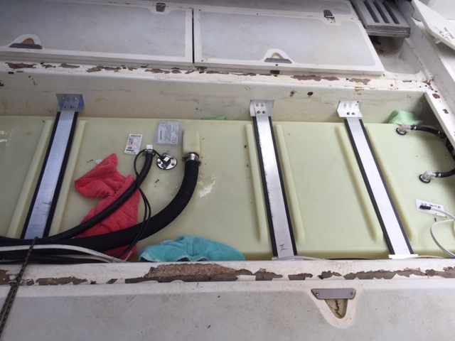

Fig. 15. New fuel tank installed in tank cavity. The aluminum straps have rubber backing glued to them with 3M5200 adhesive. In this view the straps are not yet attached to the sidewalls of the tank cavity.
Not shown are rubber mats on the sides, below, and behind the fuel tank, and on the starboard wall that the tank will rest against. The new fuel tank touches only rubber mats on all sides.

I got the 1995 OUTRAGE 24 buttoned up with deck back on. Putting it all back together is sort of anticlimactic.
I hooked up an 8-AWG grounding or bonding wire to the tank and to the fuel fill, and connected it to the negative pole of the battery, which is directly connected to the outboard. This is the engine battery, not house the house battery, but both batteries are connected together with a large battery cable.
