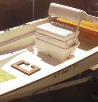

I used that same flip-back cooler seat, and it is nice for dry storage.

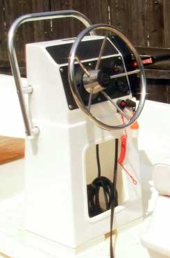

I used a very small TODD center console as there is not a lot of room on the 15-footer.
Small TODD steering console.
I see no reason why a small steering wheel would be a problem unless the loss of mechanical advantage made the steering effort unmanageable. Your boat's steering looks like a Teleflex mechanical cable, which is a very effortless design. I don't think [a smaller diameter steering wheel] would hurt.

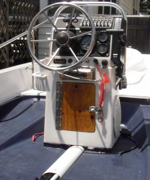

More information about modified steering console:
Console base. The gap in the base at the aft side is to allow cables to run out from under the console.
I used the long lasting mahogany on the deck where the console is mounted. I did not want the console screwed into just the fiberglass deck as the strain would be excessive. I made a base that is screwed and glued down with 3M-5200. Then the console is bolted to that. The base is rigid to the deck and any strain is taken up by the wood. Note that the folding bench seat at the stern is also mahogany. Most of it was salvaged from my first boat and is 40 years old. Mahogany is the only wood I would use on a boat.

I used the Teleflex [now known as SEA STAR SOLUTIONS--jimh] Safe-T Quick Connect. The QC merely means that I can remove the cable at the helm by inserting a wire clip tool to disconnect it. Older models used a big nut to retain the cable, similar to the nut at the engine steering arm.
I started from scratch so I had to position the helm unit to fit the console. The tube that the extended cable goes into must be free from sharp turns. Where the cable exits the console must be free of sharp turns, too.
I managed to route the cable straight down and out the bottom of the console. That way the return cable tube also pointed straight down. If you look at the illustration above for the mahogany base there is a gap. That is where the steering cable and electrical cables all exit and run to the stern. They then run under the cooler seat.
Exposed sections I covered with extruded aluminum door sill plate. That contains everything nicely and is not a trip hazard.
The center console with steering cable running out the bottom and covered on deck by an aluminum door sill plate.
