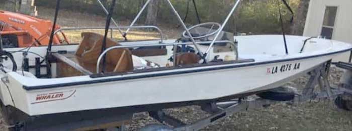

Postby Whalercougar » Sun Apr 19, 2020 12:50 pm
Unknown model.
[The poster wants readers to identify the model of Boston Whaler boat shown above, and informs that the boat] is a 1978 and measures 15.6-feet. The boat seems to be in great shape and the engine only has 100 hours.

If a 1978, it may have been a SPORT 15--a great hull--but with some aftermarket interior, it's really a 15-foot Custom. The year and interior determine the model. The Super Sport was introduced in 1984, and Super Sport Limited in 1986. That' s not to say the boat pictured in Figure-1 is not a great boat.

The console looks like some sort of molded SIDE console, and thus not an OEM console, unless that console is on center and then it could be a CENTER CONSOLE 15. It is hard to tell the location of the console from the photograph. Since the arrangement of the interior defines what model the 15-foot hull was called, a photograph with better illumination that clearly shows the interior layout will be necessary to determine if that console is OEM or aftermarket.
The Boston Whaler 15-foot hull is only 15-feet 3-inches long. Your measurement of "15.6-feet" translates to 15-feet 7-inches, too long for the 15-foot hull. Check your measurement.
The thwart seat with seat back is also likely not OEM.
You can easily get more information if you find the STENCIL NUMBER and HIN. See the FAQ for advice on STENCIL NUMBER and HIN.
If the STENCIL NUMBER and HIN identify the boat as a 1978 model year, then the boat was originally a SPORT 15, as that was the only model offered in 1978. See the 15-foot hull article linked below.

I never owned a STRIPER but that looks like an OEM STRIPER console to me with some type of modified seating. It would not be hard to get your hands on a used STRIPER console if the boat is a 1978. What year did the stripe models debut?
