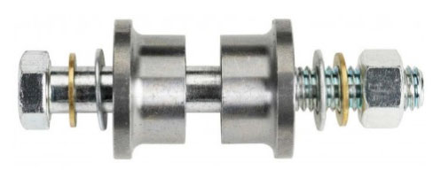

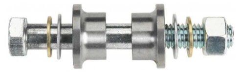

Flanging tools made by Moeller Marine are often mentioned as being used in the replacement of through-hull or through-transom drains on classic-era Boston Whaler boats that use thin-wall brass tubes for the drain pipe. The brass tubing is usually 1.00 or 1.25-inch outside diameter, varying with model and location.
The Moeller Flanging Tool, part number 020700-00 is designed to form flanges onto 1-inch-OD tubing:
Fig. 1. Moeller 1-inch Flanging Tool.
The Moeller Flanging Tool, part number 020704-00 is designed to form flanges into 1-1/4-inch-OD tubing:
Fig. 2. Moeller 1.25-inch Flanging Tool.
These tools are available from vendors that sell Moeller accessories. Some example sources are linked below.
GO2MARINE sells the 1-inch tool for about $35.
SUMMIT RACING sells the 1.25-inch tool for about $45.
The 1-inch tool is sold on AMAZON by seller "Moeller Marine" for $42; see
https://www.amazon.com/Flanging-Tool-inch-Drain-Tube/dp/B002MJBLFK
The 1.25-inch tool is sold on AMAZON by seller "Moeller" for $35; see
https://www.amazon.com/Moeller-020704-00-Tool-Flanging-1-25in-Draintube/dp/B002MJDUQ8

Postby Phil T » Tue Apr 21, 2020 2:08 pm
Sea Dog's flaring tool is $20.
https://www.fisheriessupply.com/sea-dog-line-drain-tube-flaring-tool-520290-1
A threaded rod must be substituted for the bolt supplied when flaring a long drain.
