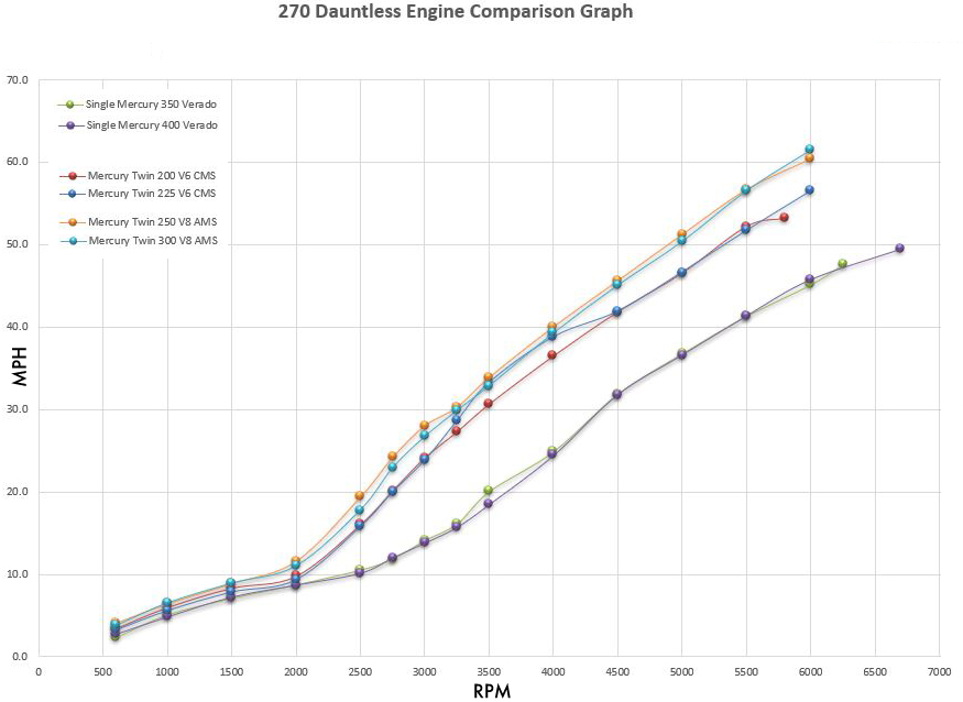

Look at the comparison performance shown on the graph in Figure 1:
Fig. 1. 270 DAUNTLESS Performance data from Boston Whaler.
With a loaded weight of 7,900-lbs (engine,fuel and water), not including gear and passengers, I don't see a 100 hp decrease making much difference.

PHIL--great chart. The twin 300-HP set-up looks like it provides mostly more attention at the intra-coastal water way restaurant dock than any actual performance gain.

Postby Phil T » Sun Jun 14, 2020 7:54 pm
Two things.
I thought the OP was asking if one could repower a 2019 Dauntless 270 model to 600hp given the newer horsepower rating, hence my research and post.
My second post took the performance chart from Bostonwhaler.com and attached it rather than attempt to point to the webpage.

Phil T wrote:My second post took the performance chart from Bostonwhaler.com and attached it rather than attempt to point to the webpage.
Yes, I think that was understood. I improved the resolution of the chart and gave it a caption to explain where it came from.
The real sweet spot in performance to me looks like twin 225-HP engines.

WAZ wrote:Are [owners of a 2019 270 DAUNTLESS boat] that have the twin 300-HP engines happy with the performance?
I bet they are. But I think a better questions would be:
Is the significantly greater cost of twin 300-HP engines compared to twin 225-HP worth the 4 to 5-MPH improvement to a top speed of over 60-MPH? I doubt the opportunity to run at 60-MPH instead of 55-MPH occurs frequently.
