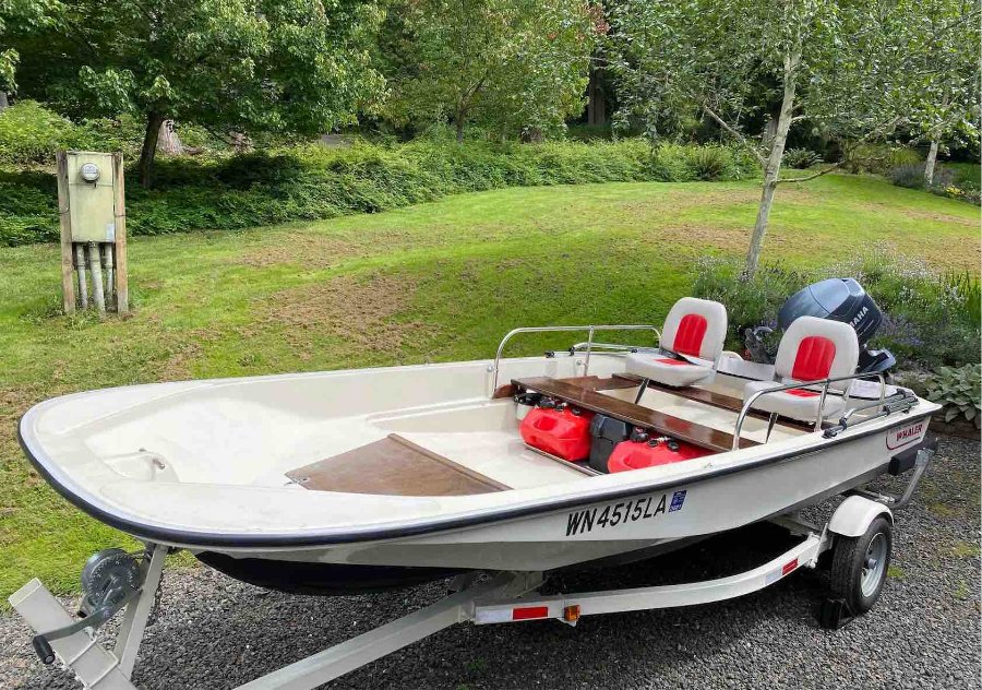

My boat is a 1976 15-footer with a 50hp Yamaha engine. It is a tiller engine- that is the only drawback.
Here is a picture of the boat:
Screen Shot 2020-07-06 at 1.08.16 PM.jpg (214.28 KiB) Viewed 4478 times
The hull has a few small cracks and spots in the gel coat.

The boat seen in an illustration above might have been at one time a SPORT 15, but it is no longer: the side console is missing. The thwart seats are mounted in different positions and are now attached atop the riser instead of sitting on the notch in the inwale.
