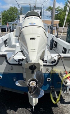

Fig. 1. DF140A engine mounting with engine height not clearly shown.

Re: 1995 Outrage 19 SUZUKI DF140A
Postby jimh » Wed Jul 15, 2020 4:56 pm
The view of the engine in Figure 1 does not clearly show the mounting height.
The engine is likely mounted in the lowest possible position.
