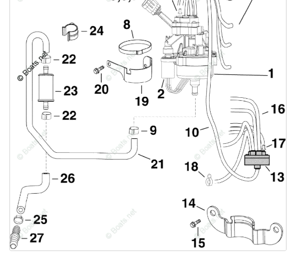

The filter is part number 5004958 and is on the oil line coming from the remote tank to the oil pump. It is show as item 23 on this diagram.

You must have the "small block" 2.6L E-TEC which has a filter. It is important to note the the arrow on the filter is installed AGAINST the flow of oil otherwise it will develop vaccum bubbles and throw an alarm. This seems counterintuitive, but the Evrinde manual and service bullietins state this installation practive for this exact reason.

DTMACKEY--very interesting information. I have the larger V6 3.3-lter E-TEC. It has an in-line oil filter, too, but I never noticed it before this mentioning of it. But there is no direction arrow on that oil filter.
We really don't explicitly know which V6 200-HP is under discussion here, but from the illustration above we can infer it is the smaller 2.6-liter V6 model.

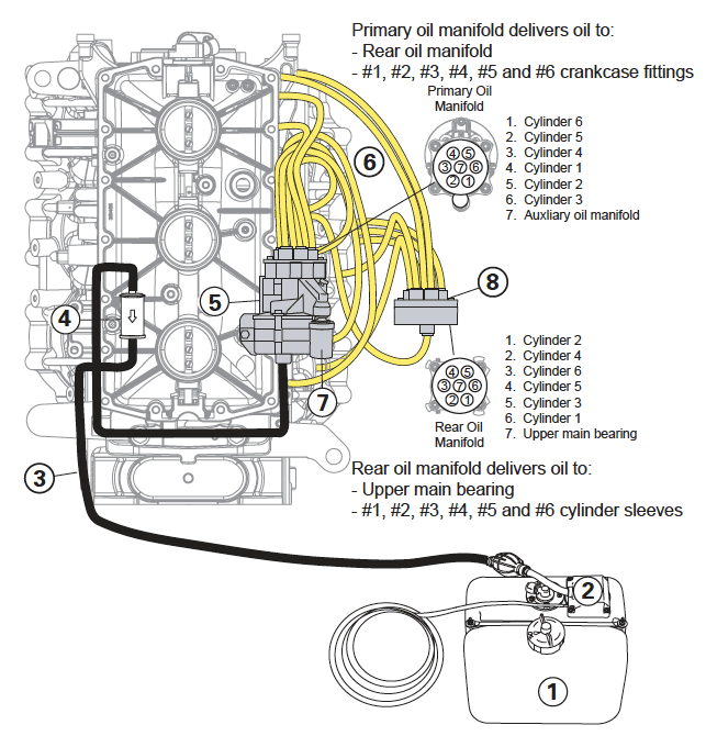

Here is the OEM diagram for the smaller V6 200-HP with the direction arrow shown on the in-line oil filter:
Fig. 1. Oil hose routing diagram for 2010 model year E-TEC 200 V6 2.6-liter
The factory manual notes:
IMPORTANT: 60° Models – Arrow on oil filter faces incoming oil.

Squeeze the oil primer bulb to flow oil from the hose connection, through the filter, to the oil pump. Visually inspect filter to ensure that all air has
been purged.
Continue squeezing the primer until oil flows through the distribution manifold into the oil distribution
hoses and to the crankcase fittings. All air must be eliminated from oil lines. Use Evinrude Diagnostics software to make sure the EMM is programmed for the type of oil being used. Start the outboard and use the oil priming function in the software for a minimum of 90 seconds to make sure the system is completely primed.
Observe oil flow through the oil distribution hoses.
Make sure that oil flows through the rear oil distribution
manifold to the cylinder block fittings.
Small bubbles are acceptable. Large bubbles must be eliminated through continued priming.
IMPORTANT: All clear “blue” oil distribution hoses on the powerhead should fill with oil as the air is purged from the lines.
