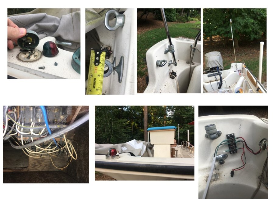

I will describe my navigation lamp replacement project on my 1972 COHASSET II 16 classic. This job was 90-percent research and planning and 10-percent effort.
The [original] wiring [for the combined sidelight lamp at the bow] was laid in the [Unibond hull interior foam]. [My new wiring would require] a drill-through-the-hull [installation]. Fortunately my boat already had the three-piece rub rail installed by a previous owner so running the wiring through the black [vinyl center insert] channel [of the three-piece rub rail] was a breeze.
The [combined sidelight lamp and white all-round pole lamp were purchased from] Specialty Marine. The lamps use LED bulbs.
I tested the lamps before drilling.
The [pole lamp] fit in existing original hardware. I purchased a rubber insert, but I already had a suitable rubber gasket in place and it worked well.
At the console a Cole-Hersee M-476 switch was used. The switch terminal marking R is for Rear (half-pull), H for Headlight (full pull), and A and B are Battery: the nomenclature comes from use in automobiles.
The utility of navigation lighting is secondary to passing an inspection and just wanting the lamps to work. I thought using a switch to permit just the all-round light when anchored and both [sidelights and all-round] when underway was useful.
Sorting out and tracing the fuse box and block was fun.
I used Ancor tinned wire.
I splurged and bought a ratcheting crimper for the [wire] connectors. The crimper worked well.
From the console to the stern terminal block a three conductor cable [with insulated conductors in colors green, white, and another color] was used. I used the green conductor for the sidelight lamp power (as green in the light). I used the white conductor for the white all-round lamp power. [Apparently the other conductor was used as the common or negative return circuit. Perhaps this was a black conductor as the combination green-white-black insulation is common in 120-VAC wiring—Moderator.]
The old terminal block location was filled with some 3M 4200 for now. [In the future I will repair] this area with MarineTex. The new terminal location works better for me. I went without a box.
The liquid electrical tape has not been painted on yet.
A stainless vent covers the wiring thru-hull at the stern.
Any [holes drilled through the hull] were filled with 3M4200.
Special thanks to all for maintaining this wonderful resource and body of knowledge. With it, I am eager to celebrate my boat's 50th birthday in April 2022.
Fig. 1. Collage
