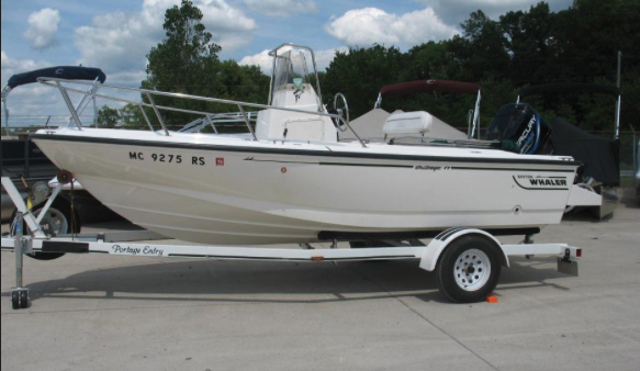

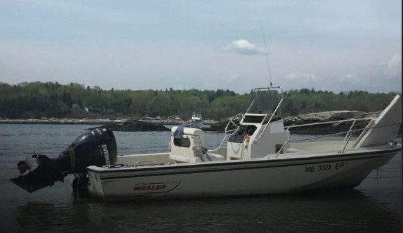

The boat in question, a 1998 Outrage 17 II is a different design than the 1990-1995 Outrage 17 I and does not have the stern weight sensitivity.
1996-1999 Outrage 17 II:
1990-1995 Outrage 17 I:
