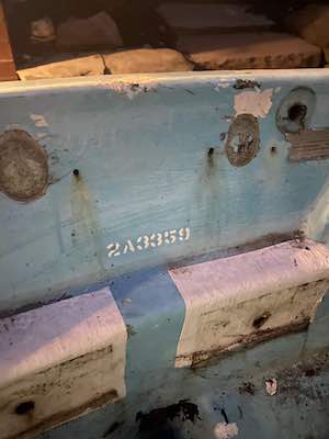

Hope you enjoy [these images]. I'm having a blast restoring this 1970 13 Sport.So much sanding.

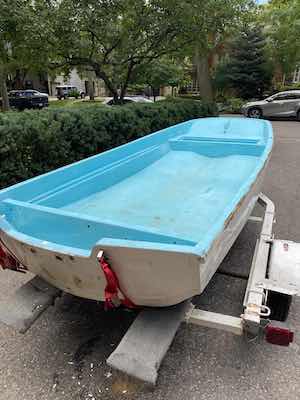

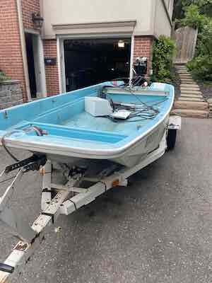

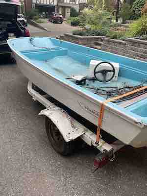

Some early pics after picking it up - stripped down, sold the 50-HP, power washed, and ready to get going.

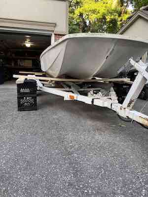

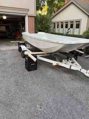

get the boat off the trailer - grind and sand down the top side

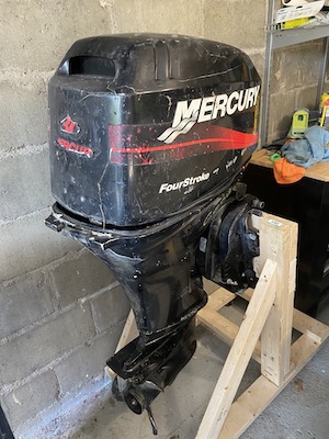

picked up a short shaft 4stroke 30hp, that's been upgraded to 40hp. Plus the new interior arrives.

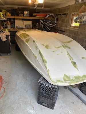

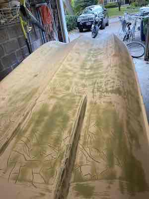

sanding, grinding and fairing the hull

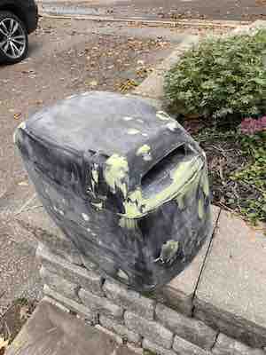

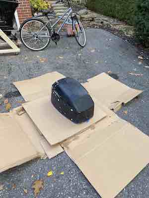

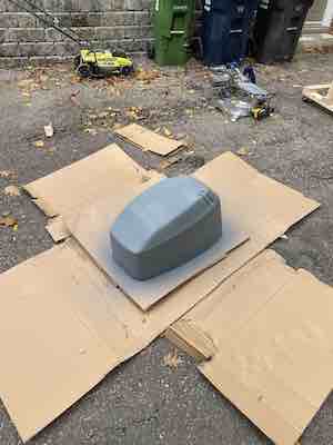

Engine Cowl restoration

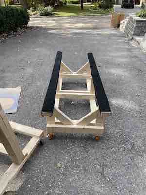

3 coats Primer on the hull. The dolly is built for when the boat is flipped back over upright.

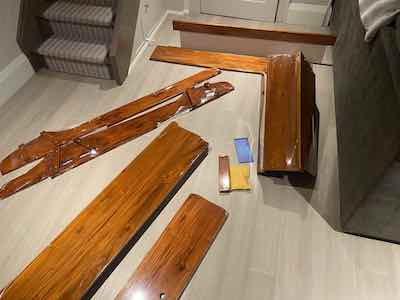

Where did you get the interior wood?
I need to replace [the interior wood] on my 1981 13-footer.

[The wood interior was purchased] from [Specialty Marine]. I [placed the] order on-line.

Is the dolly [seen above in a photo] made with 2 x 4 lumber?
How long is the dolly?
How far apart are the bunks?

Hi Bill--yes [the cradle seen above was] all done with 2x4's. It holds the boat perfectly. Originally I thought I would have to strap down the boat, but that is not needed at all.
Width is 26-inches (outside dimensions of the bunks). Length is 5-feet, There are two 8-inche overhangs, so 76-inches total. More at
https://jamesanthonynovak.wixsite.com/whaler13project/post/build-a-dolly
