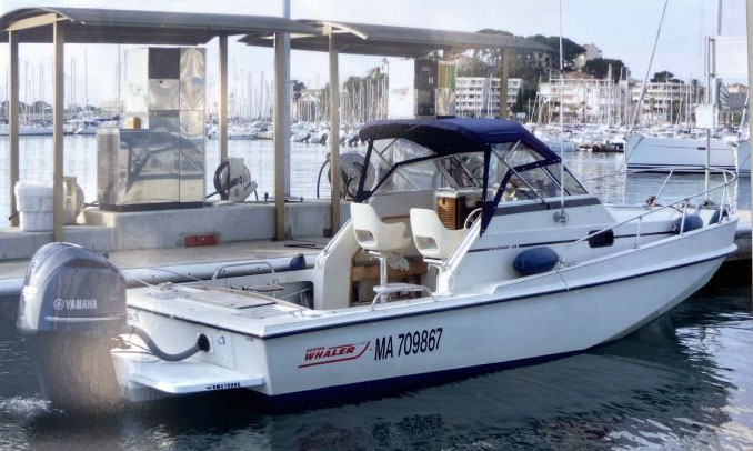

Fig. 1. 1986 25 REVENGE for sale in France.
[Based on Figure 1] is the engine bracket an OEM Whaler Drive?

In the 1986 Boston Whaler catalogue the boat is called a REVENGE 25 FULL CABIN. It is also called a REVENGE 25 Walkaround in some other literature. The boat was available with three power options: outboard engines with a notched transom; Sea Drive engines with a full transom, or; sterndrive engine with a full transom. There was no option listed for a Whaler Drive.
The engine bracket shown in Figure 1 does not look like an OEM Whaler Drive engine bracket. Typically a Whaler Drive will have a much larger buoyancy box that extends the full width of the bracket. The bracket in Figure 1 only has a buoyancy box in the center portion of the engine bracket. The bracket may be aluminum. A Whaler Drive would be of molded fiberglass construction.
The boat may have been originally built for Sea Drive engines, which could have been replaced with a non-OEM engine bracket and an outboard engine, as shown. This history for the boat is the most likely.
If the boat were originally built for outboard engines it would have had a notched transom. If that were the case, then the full transom conversion was done after the boat left the factory.
The boat was rated for maximum horsepower of 300-HP.
The top speed of the boat will have to be estimated based on total weight, power, and hull type.

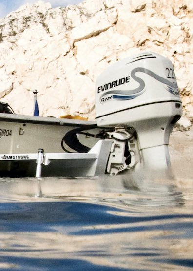

I have found some explanations and pictures about replacing a [OMC Sea Drive] by a Armstrong bracket on a 27FC [on some other website.] and that boat seems to be the same technical case as this boat.

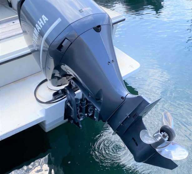

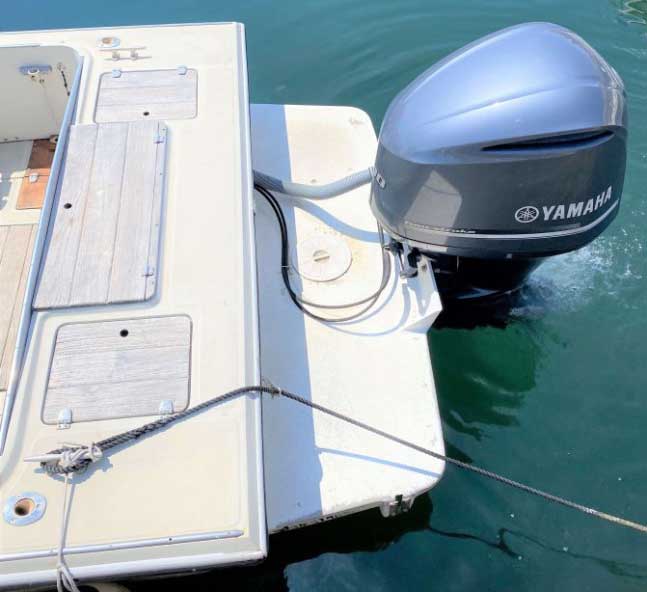

Some pictures of the Yamaha F300 and the cockpit
Fig. 2. The Yamaha F300 engine
Fig. 3. The Yamaha F300 engine

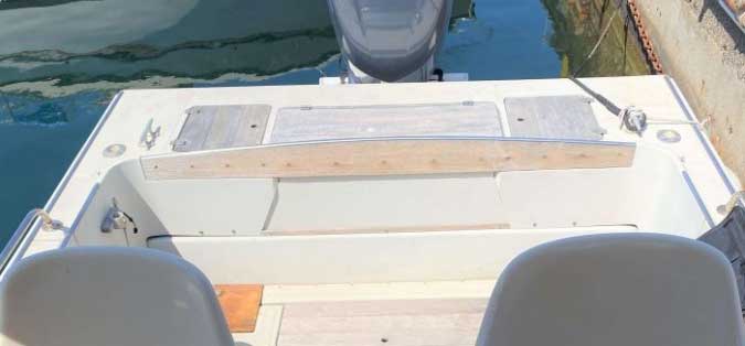

Fig. 4. The aft cockpit

The aft cockpit bulkhead as shown in Figure 4 looks a bit unusual to me. Compare how that bulkhead appears with the bulkhead on an OUTRAGE 25 that was ordered as a Stern Drive Blank which appears below as Figure 5.
Fig. 5. The cockpit aft bulkhead on a 25-foot OUTRAGE that was ordered as a Sea Drive Blank. Note how the cockpit aft bulkhead differs significantly from the one seen above in Figure 4.
Fig. 6. Another view of the aft cockpit bulkhead on a 25-foot OUTRAGE that was ordered as a Sea Drive Blank. Note how the cockpit aft bulkhead differs significantly from the one seen above in Figure 4. There is no missing center section as seen in FIgure 4.
I am now wondering if the boat under discussion might have originally been made as a stern drive model because of the cut out in the aft cockpit bulkhead that seems to correspond to where the cockpit engine box would have been on a stern drive model.

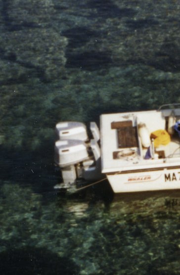

Look at the pictures, it seems two SEA DRIVE engines were on the boat before this new bracket. And the winner is SEA DRIVE mounts.
