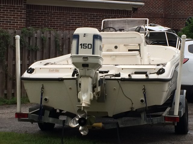

I owned a 1999 Dauntless 18 for ten years. It was powered by a 1998 Evinrude 150 Ocean Pro carburetor engine set on a jack plate. I used a 17-pitch four-bladed propeller.
Fig. 1. The previously owned 1999 Dauntless 18 boat with a 1998 Evinrude 150 carburetor engine.

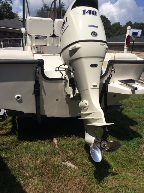

I now own a 2003 190 Nantucket powered by a 2016 Suzuki DF 140a, so I have experience with both the hull and engine, just not together.
Fig. 2. The currently owned 2003 190 Nantucket powered by a 2016 Suzuki DF 140a
On the DF140a engine [on the 190 NANTUCKET--a different boat than the boat under discussion in this thread] I am using a Suzuki 20-pitch three-bladed propeller. This 20-pitch three-bladed propeller gives me a good mix between [acceleration from a standing start at full throttle] and cruising speed.
For the [18 DAUNTLESS boat under discussion in this thread] I suggest starting with a Suzuki 20-pitch three-bladed propeller on the Suzuki DF140 engine.
