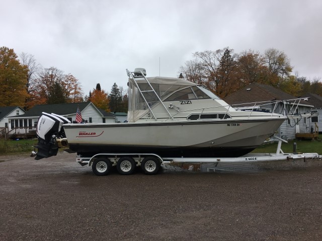

I have never seen a trailer set up for a Boston Whaler boat with a Whaler Drive that provided support for the Whaler Drive. If you look at the geometry of the boat hull keel compared with the Whaler Drive bottom, you should see the two are not in the same plane.
I have a 22-foot hull with Whaler Drive. The Whaler Drive hangs off the back of the trailer.
Figure 1. A Whaler Drive with boat on trailer.
Figure 2. The end of the trailer frame is at the same point as the red taillight lamp. The trailer bunks extend a few inches farther aft. The Whaler Drive is not supported by the trailer bunks or keel rollers.
Fig. 3. Whaler Drive boat on trailer.
Fig. 4. Whaler Drive boat on trailer.
Fig. 5. 27-footer boat with GIL Bracket on trailer.
