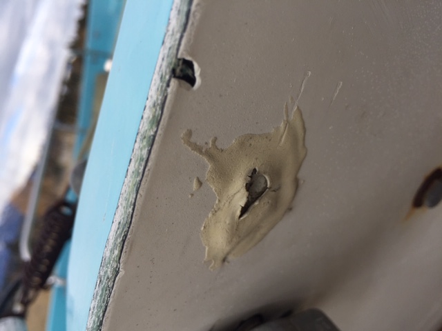

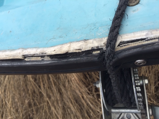

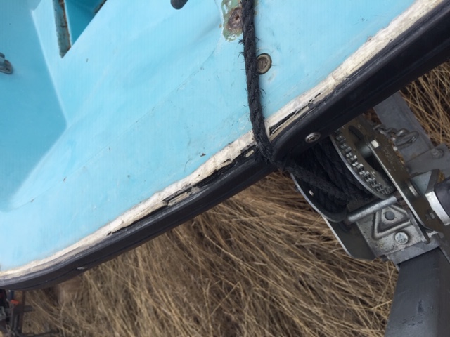

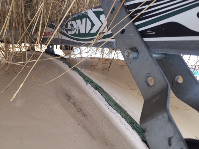

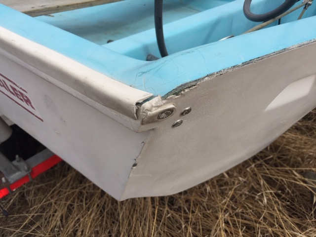

Please give me some feedback on the extent of the damage you can see in the 1968 13-footer shown in Figures 1 to 8:
Fig. 1.
01 IMG_9330.JPG (95.34 KiB) Viewed 3421 times
Fig. 2.
02 IMG_9336.JPG (106.18 KiB) Viewed 3421 times

IgbyMac wrote:Please give me some feedback on the extent of the damage you can see in the 1968 13-footer shown in Figures 1, 2, and 3.
Figure 1 show damage to the port stern quarter. The rub rail molding has been fractured. The structural joint between the hull and liner has been damaged.
In Figure 2 the rub rail has been damaged. The joint between hull and liner has been damaged.
In Figure 3 the keel has been damaged. The gel coat layer has been abraded away and the inner laminate layer is now exposed to water.

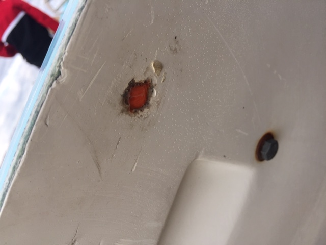

Figure 4 shows damage to the starboard stern quarter. The rub rail molding has been broken. There is apparent abrasion at the green-line joint between hull and liner at the transom top edge.

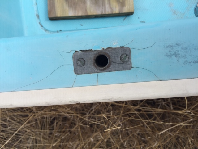

Figure 5 shows stress cracking at an oarlock; this is cosmetic not structural.

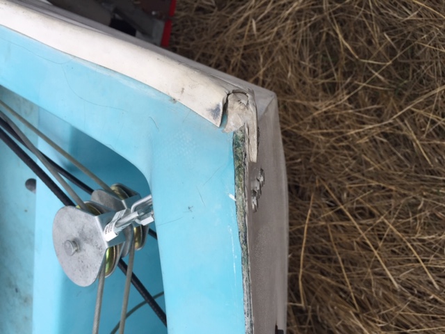

Figure 6 shows a blob of something in some location, probably some old sealant around some hole, perhaps an engine mounting hole. This is not damage. It is just a blob.
Figure 7 shows what may be the transom near the hand hold area with damage to the gel coat layer.
Figure 8 shows the same damage as seen in Figure 2. See my remarks above for Figure 2.
IgbyMac wrote:Q1: How much work am I looking at?
Enough to keep you busy for several months, assuming you work on it in your spare time.
