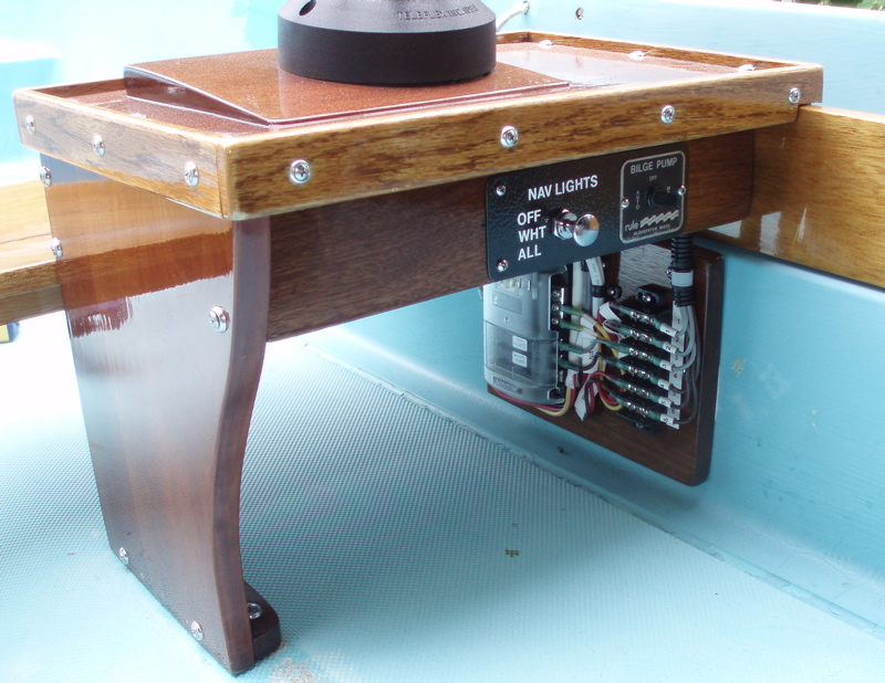

Below you can see the wiring method I used on my 1966 13-foot Sport:
Fig. 1. Blue Sea Systems Seas ST fuse block on 13-foot open skiff
The 10-AWG conductor supplying power to the fuse block was protected with an in-line fuse near the battery.

The wiring in Figure 1 looks great and appears to be well done. Thanks for sharing your work.
Why was a power distribution panel with terminal AND a terminal block used?
Isn't just need one set of terminals needed, not two?

Postby Tom Hemphill » Sat Apr 03, 2021 4:14 pm
Thank you for the compliment.
The second terminal block provides a single disconnect point for all items attached to the console for ease of maintenance.

It appears that the wiring includes some intermediate circuit elements such as switches between the terminals on the power distribution panel on the left in Figure 1 and the terminal wiring strip on the right. The wiring may be laid out so the console can be removed from the boat while the power distribution panel remains in place by disconnecting the six wires that go to the six terminals on the right.

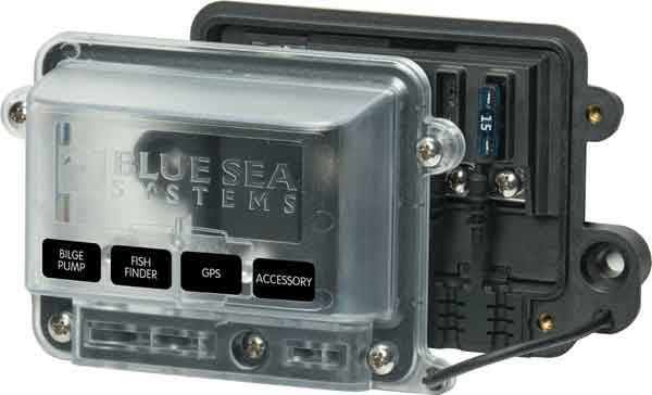

[Blue Sea Systems] has a new product: a water-resistant fuse block, part number 4056.
I used it on my 13-footer. It is a good product.
Re: Power Distribution on 13-foot Skiff
Postby jimh » Thu Apr 08, 2021 7:41 am
PATSEA--I don't see any Blue Sea Systems product with part number 4056. I think that number is wrong. But I like the concept of a Blue Sea Systems water-resistant fuse panel.
I searched at Blue Sea Systems and found they have a new product, a water-resistant fuse panel, that is part number 5056. This component looks appropriate for use in an open skiff boat for distribution of electrical power. The MSRP is about $44. While it has only four branch circuits, for use on a 13-foot open skiff that should be sufficient for accessories.
Like many Blue Sea System products, the model 5056 water-resistant fuse panel is very nicely designed. It has sealing glands for the electrical conductors to pass through to enter the enclosure.
Fig. 2. BLUE SEA SYSTEMS fuse block 5056.
More information at:
https://www.bluesea.com/products/5056/ST-Blade_Water-Resistant_Fuse_Block
