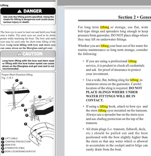

Here are the pages from the manual.
Screen Shot 2021-04-07 at 9.31.50 PM.jpeg (85.21 KiB) Viewed 10962 times

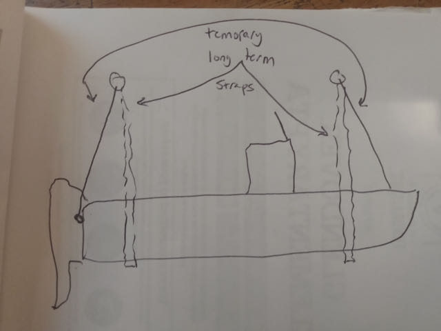

Personally I would lift the boat with wire cables then position wide lifting straps slightly forward of the transom and a second aft of the bow and support the hull that way.
The straps would be set at a fixed height and the wire rope would be for lifting and lowering only. All weight would be on the straps.
For storage for a few days, use the eyes.
Once you figure out the rigging, it should not be hard.
Here is a rough drawing.

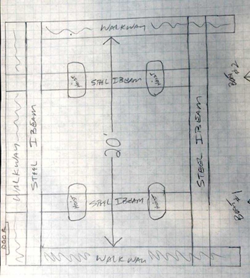

I decided to draw what the boathouse looks like since you all had some great ideas on how to add additional support.
[Changed topic to discuss how to upload images and make them in-line. Please visit the INTRODUCTION FORUM and read the article on adding images files to a post and maximum image size. The GAM forum is for boating topics. The INTRODUCTION forum is for help with using the forum software.--Moderator]
The width of the internal boat house prohibits me from sticking boards underneath because they would need to be more than 20' long. The boathouse is one big slip. It would also be hard for me to add additional wide straps to wrap underneath for extra support unless I got into the water or used a hook to grab one end of it from one side of the boat to the other. Nothing is impossible however doing these two suggestions would be something I wouldn't want to do.

Fig. 1.

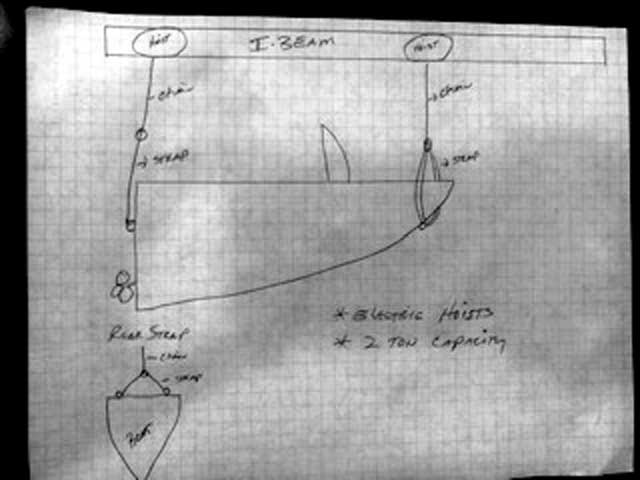

Fig. 2. Hoist strap detail.

Thanks Phil. My hoists are rated at 2-tons each they have a chain with a loop at the end which I then connect industrial straps to each hoist independently then to the boat eyes. The straps are nylon and rated for 4-tons each. My concern is more about the potential of damaging my new 170 MONTAUK rather than keeping secure. With the boat in the boathouse, it would be very protected and secure.

What is the dimension for the distance between the I-beams the support the hoists in Figure 1?
Is the location of the hoists on the beam supports fixed or moveable?
From Figure 1 I infer the boathouse is open to the sea on the right.
[Note: I reoriented the image files in Figure 1 and 2 to make the text upright when viewed as in-line files in HTML.]

In order to create the least stress on the attachment points on the boat for hoisting, the direction of the lifting force should be completely vertical, that is, the hoist rope (or chain or strap) should be hanging down perfectly vertically when connected to each eye. In this way there won't be any lateral forces created on the lifting eyes; the load will just be vertical. Any change from a perfectly vertical lifting rope will create compressive or elongation forces on the attachment points (the eyes) and then transmit those forces to the hull.
If all the hoists and support beams are fixed in place and cannot be moved to fit the boat's lifting eye layout, the most effective way to move the lifting points so they align with the eyes on the boat is to make a frame--usually called a strong back frame. The lifting straps to the boat attach to the strong back so they pull up perfectly vertically, while the chains from the hoists attach to the strong back where needed. Considering the total weight of a 170 MONTAUK to be lifted, the strong back frame could probably be made from timber to save money, or to save weight from aluminum.
If designed with an eye to creating room for the center console windshield, the strong back frame could end up positioned rather close to the boat, that is, the strong back would not have to be kept entirely clear of the console windshield; the windshield and console would fit into an opening of the strong back frame.
With this method, the lifting forces would be kept to just the vertical direction, and no sideways forces would be exerted on the lifting eyes or their surrounding hull structure.

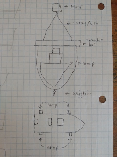

Instead of a two step hoist I described above, consider going with a spreader bar type setup.
From each hoist would be two straps/wire cable to a spreader bar the legnth necessary to span the beam of the boat.
From the each spreader bar a strap (with small weights) would fall from the end, down and around and back up.
One would enter the boat house with the straps in the water ~1ft. On reaching a location where the straps were lined up with pre-set marks on the gunwale, the hoists would raise the boat.
Given the boat only needs to be lifted a 1-2 feet off the water, if a strap did fail, it would not be catastrophic.
Horrible drawing not to scale:
Drawing

JIMH--I think the distance between the two I-beams the hoists are at least 10-feet. The width of the whole bay accommodates two boats to fit into the boathouse. The I-beams are rated at more than 15-tons. The hoists are connected to the lower portion of the beam and operate on wheels, and in that way they automatically adjust to the size of the boat, always creating vertical lift and reducing stress. The boathouse is on a large inland lake. There is a vinyl door that rolls up and down to protect the boats from any outdoor weather. Thank you for adjusting the images.
