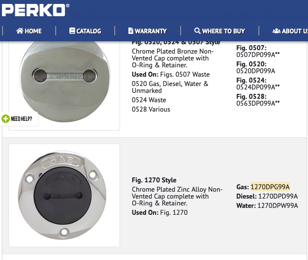

It could also be a Perko cap.
From the Perko catalog:
