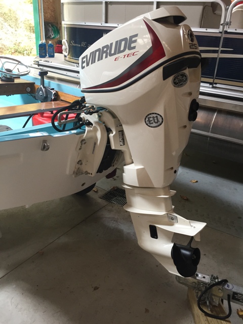

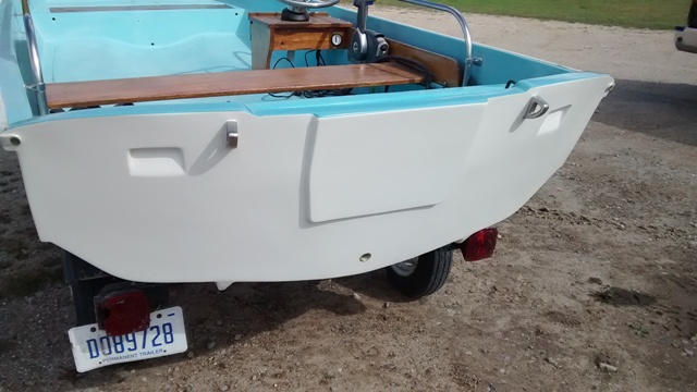

Due to some winter damage to my outboard done by a nesting mouse, I decided it was time to re-power my classic 13-footer. I wanted an E-TEC 25, but it is not available with power trim and tilt in a 15-inch shaft. I had to modify the transom on my 13 to handle a 20-inch shaft. Fortunately my local Evinrude dealer knew a fiberglass guy that is a perfectionist.
The fiberglass artisan built up the transom to handle the 20-inch shaft. Then when he was done he didn't like the looks of the curved shims that would be required to accommodate the original curve in the transom. So he decided to redo it at his expense! He added a flat pad to match the motor and glassed it in to look as if it was part of the original Boston Whaler design. He even went so far as to redo the hull number on the transom matching the factory original font.
I can't wait to splash the boat a do a sea trial.
Flat Transom Pad
Completed Transom with repainted hull number

New E-TEC mounted on boat.
2015-10-13 13.51.20.jpg (121.32 KiB) Viewed 11805 times

I really like the method Don used to raise the transom height of a classic 13-footer to accommodate outboard engines with 20-inch shaft length. Adding the flat transom insert is a really good idea.
Boston Whaler did that themselves on the 15-foot hull's transom, which is otherwise quite curvy. They put in a flat section just in the center for the outboard engine mounting bracket to bear against. You can see it in this rear view:
I wonder if the original reason for having a curve to the 13-footer transom was to add some strength to the shape. I am not a mechanical engineer, but I think perhaps having some curve to the transom might make it more rigid than a flat plane.
I hope to see that boat at Mullet Lake next season, and take it for a spin, too. Thanks for posting this interesting report on your 13-foot Boston Whaler modification.

Postby Phil T » Sat Oct 24, 2015 5:24 pm
Another great refinement.
I would double check the rigging height. The motor looks to be mounted too low. E-TEC's like to be mounted rather high (3 holes up)

Phil, I haven't had a chance to sea trial the boat yet. I hope that the weather next week will allow me to do that while I am at the cottage. Thanks for the advice I will certainly pay attention to the height as I "tune in" the setup.
