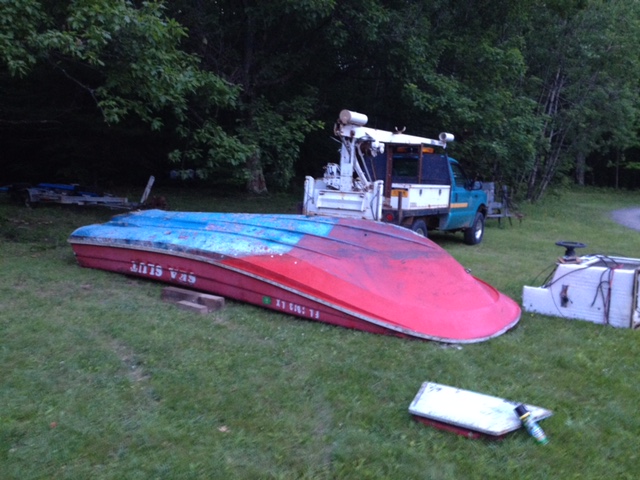

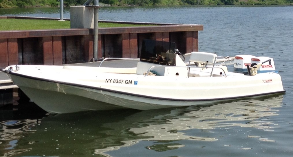

Here is a picture of that boat before restoration began. The boat was rough, but it turned a lot of heads afterwards--and caught a TON of salmon. And by the way, the retailer I purchased the Duratec from was Dynagrout in New York, but I'd contact Hawkeye Industries for someone local.

Your restored 21 OUTRAGE looks very nice. I am always most impressed by a restoration that started with a boat whose condition was about a "3" and ends up with a boat at a "9" or "10."

Thanks Jim. That boat was worse than it looks in that picture, probably should have been scrapped but the floors and transom were rock solid so I figured it was worth the effort. Now I'm doing a '73 outrage 21 that had been sitting in a barn for 25 years. It doesn't need to be refinished (just doing the teak and having a new fuel tank built) - and in hopes of a bit more speed, I picked up a pair of 70 evinrudes and hung the Bearcats on the barn wall for a short vacation. I bought a nice Atlantic Towers T top for it but I'm having second thoughts about drilling a bunch of holes and gooping up the deck with 5200, may go with the Mills canvas instead.
