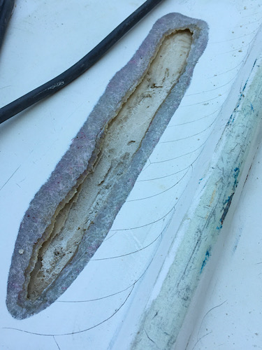

Fig. 1. An area to be repaired.
My SPORT 13 has water intrusion. The boat sat for about three years out of the water
Some of the foam [inside the Unibond] hull was saturated [presumably held water].
Q1: will [epoxy resin cure and form a bond to] wet foam?
Q2: [for epoxy resin to cure and form a bond to the foam in a Unibond hull] does the foam need to be completely dry?
Tell me how YOU would proceed [to make a repair with epoxy resin to an area of damage where the foam is holding water and is not dry]

Aschubox wrote:Tell me how YOU would proceed [to make a repair with epoxy resin to an area of damage where the foam is holding water and is not dry]
I would dry the foam before attempting to make a bond to the foam with epoxy resin.
