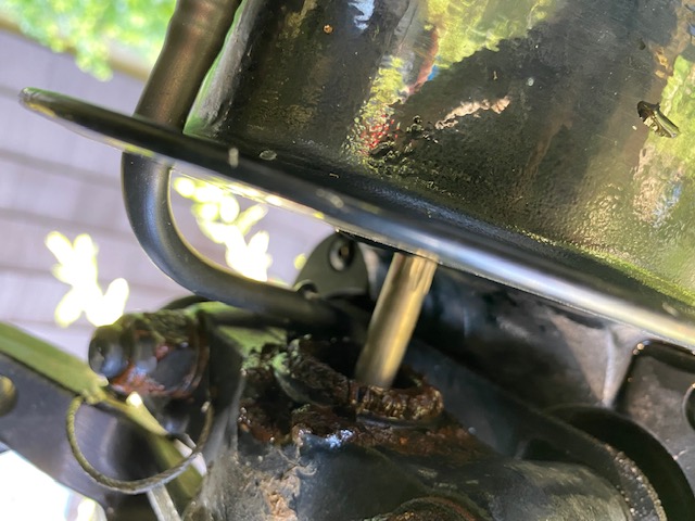

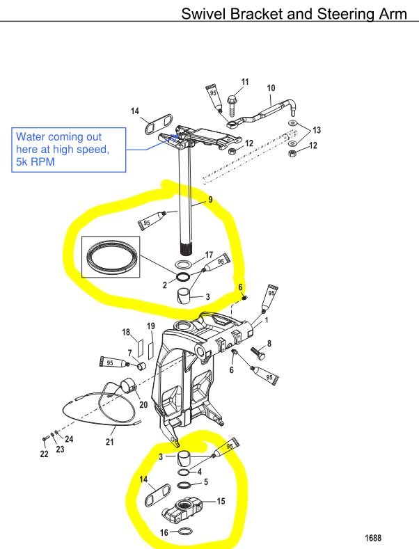

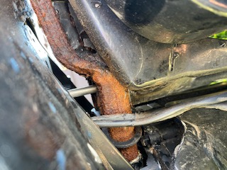

On a 2006 Mercury Optimax 75 water comes up and out the top of the swivel assembly where the shift shaft threads.
Fig. 1
Fig. 2.
Fig. 3.
I only see this excess water during flushing, at boat speeds greater than 30-MPH, and at engine speeds greater than 5,000-RPM.
Is this normal?
Did I miss a gasket or seal when I removed lower unit to replace water pump?

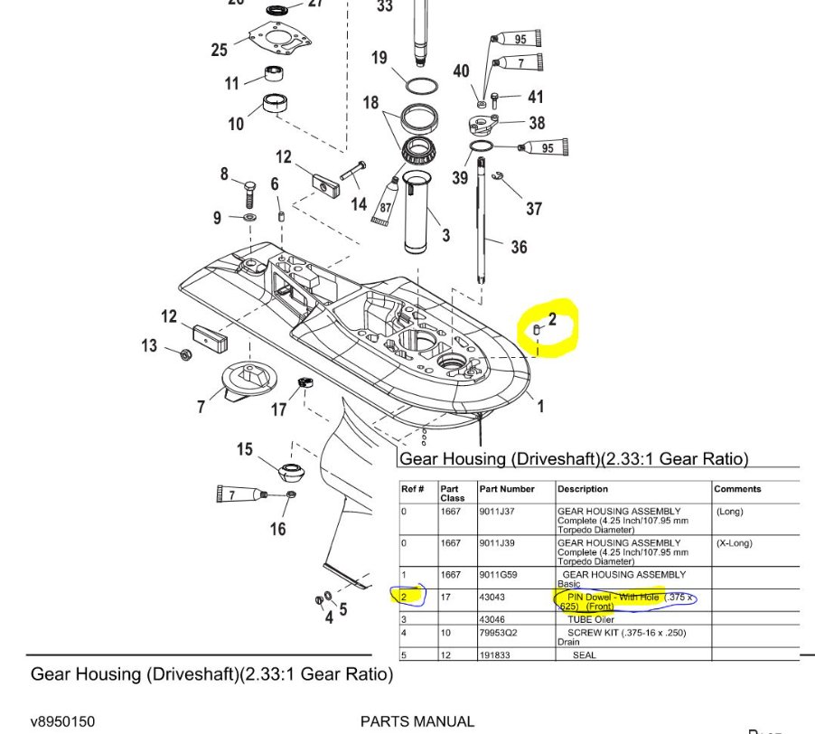

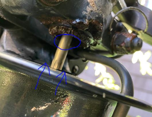

Understood, the steering tube is not connected to the water pump but somehow water is projecting itself up the steering tube towards the swivel only at high speeds. You might be right, maybe I just never noticed before but something still seems wrong. I'm wondering if that's why my swivel bracket is so rusted?
Like you say in your last comment, the water seems to be coming up (blue arrows in the image below) from where the shift shaft spline enters the lower unit. What would be causing this? I am not sure what the copper tube you are referencing is? Is it the "Pin dowel" I have highlighted in the parts diagram?
Could the "donut" be a solution? Would the "donut" be located where I circled in the picture?

In Figure 3 what is the legend for callout 9?
CiancioloNauset71
Posts: 13
Joined: Wed Sep 06, 2017 8:09 am
Re: 2006 Mercury OptiMax 75 Water in Swivel Tube
Postby CiancioloNauset71 » Thu Jul 08, 2021 9:39 am
In figure 3, call out 9 is the Swivel Pin Assembly (Part #99661A35)
