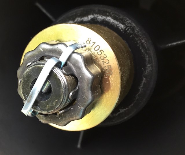

Installation of the RBX-100 hub kit into the Mercury MIRAGEplus propeller was simple. The fit was perfect. I applied some water-alcohol mix to the rubber to help reduce friction on the initial insertion. A 2x4 wood block and a hammer were used to tamp down the RBX hub to be flush with the metal of the propeller.
The thrust washer was already in a small plastic sealed bag and had a coating of light grease. It fit the taper on the Evinrude propeller shaft very nicely.
The propeller with rubber hub in place was then fitted onto the propeller shaft.
The aft spacer is then added, and next the OEM propeller nut is threaded onto the propeller shaft. Initially the aft spacer appears to be too long, but once the propeller nut is tightened, the rubber insert will be pressed more deeply into the recess, and the fit then becomes correct.
The propeller nut was then tightened to 55-foot-pounds using a torque wrench. That figure is from Evinrude not SOLAS.
Finally the OEM keeper washer was positioned onto the nut and retained with a suitable cotter pin.
Fig. 1. The SOLAS RBX-100 hub kit installed, showing aft spacer with OEM propeller nut, keeper, and cotter pin.

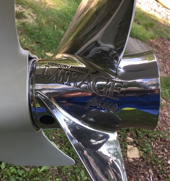

The fit between the propeller hub and the gear case on the outboard was excellent.
Fig. 2. Fitment of the Mercury propeller onto the E-TEC gear case using the RXB-100 hub kit was very good. The clearance between the gear case bullet and the propeller's larger diameter section was about 1/4-inch.
